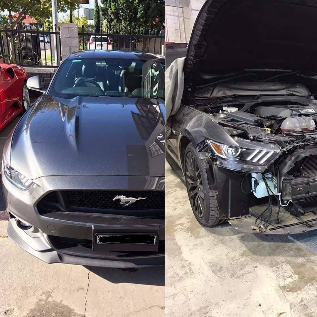

Thats the strange part, the image found is connected to a website for upholstery work in bangalore. So I have no idea when it was taken.can I ask what type of site you found it on?
was it for sale at the time?
