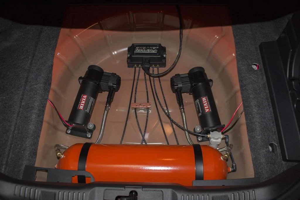

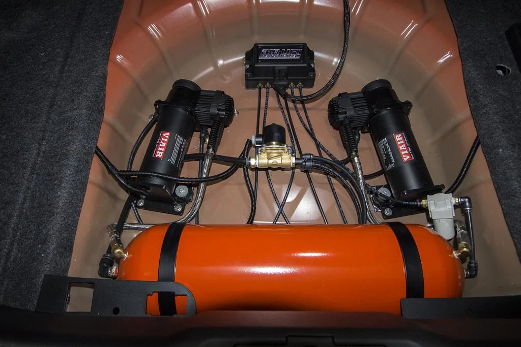

Here's my trunk setup before I did the train horn install.
Here's the setup after the train horn install along with some added wire loom.

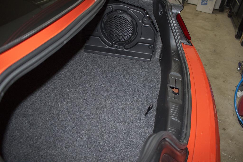

With the tire well covered, you wouldn't even know it was all there lol.
Quick question for you sir, what size is the air tank? 4 or 5 gal?
Thank you!

Looks like a 2.5 maybe a 3 gallon

All you will need is a single tank and compressor. That's all that would really fit in the spare tire well

No that's an overkill. I run a 2.5 gallon tank and 1 440 compressor.

When you decide to get your kit you can tell them you want a smaller tank. The standard tank that I usually sell to all of my customers is 4 gallon. Some want bigger some want smaller.
