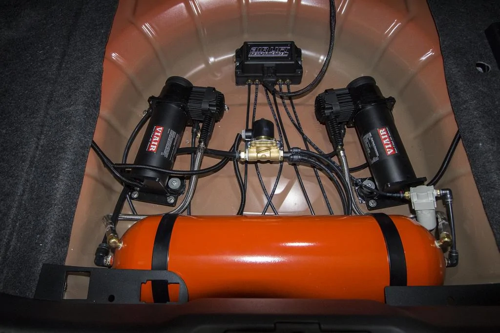

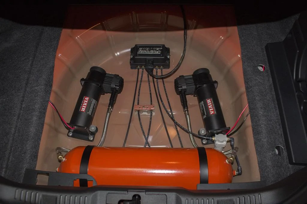

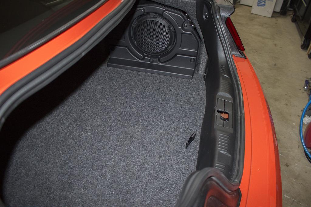

Where did you run the 3/8" lines? I've heard that they are a bear to run and you cannot run them through the sill plate from the front of the car. I did some research today on the air zenith versus the viair and a lot of reviewers recommended the viair for reliability. Hopefully you'll be good.My one compressor puts out more air and is quieter than dual 440 Via pumps. That's why I chose it. Also, I have a flow control valve on the exhaust side so I can slow down the lowering. For the guy that asked......my trunk is not "truck liner", it has a 3M sound dampening coat followed up by a texture paint.
Is that a 4 gallon tank in your setup and if so what brand is it?
