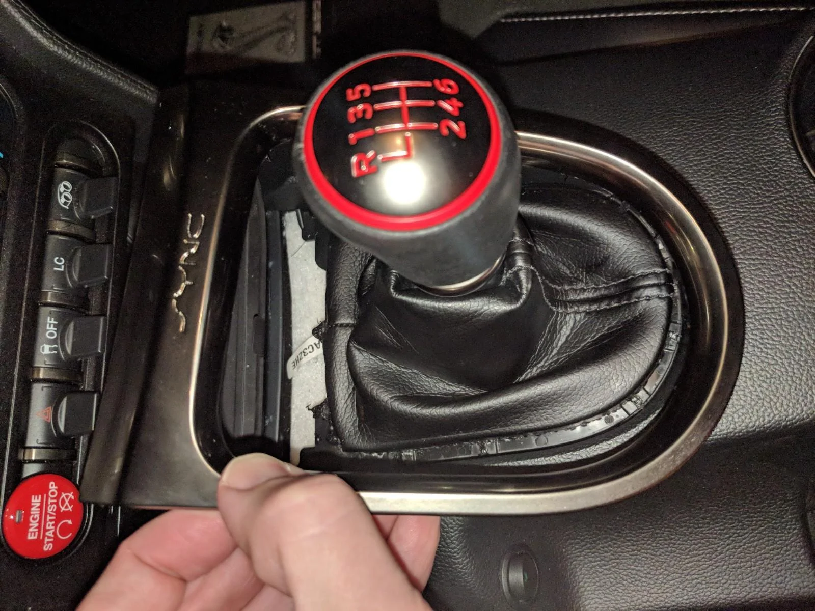

Thanks for the heads up. I know my compressor is failing secondary to the evaporator problem. Just a matter of time, so I will get it fixed now, have a year of warranty left on the AC. Hopefully the compressor comes with new bolts, sounds like it doesn't (probably the same compressor used on all S550s which typically don't need new bolts) which is a recipe for disaster. I'm also hoping since they just put in the new evaporator they won't need to take the dash apart again, but not sure on that. They broke the metal ring with the word "SYNC" on it in the process, it's on my list as well.

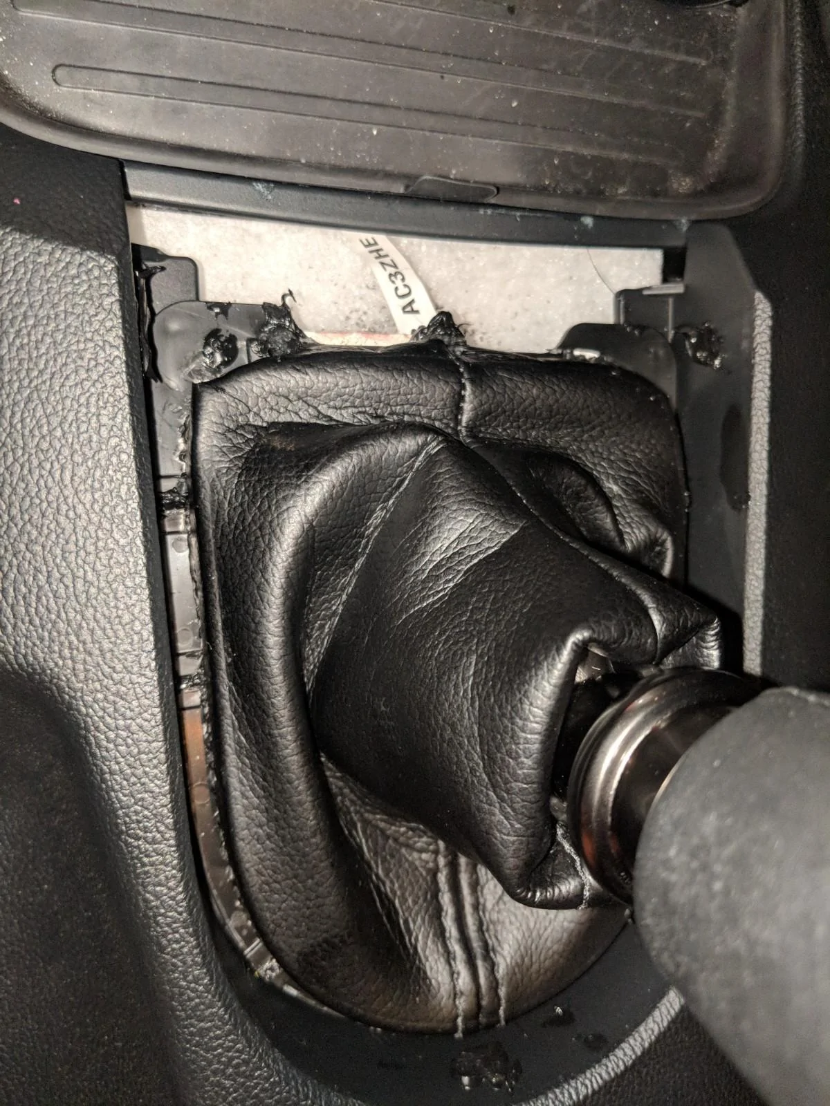

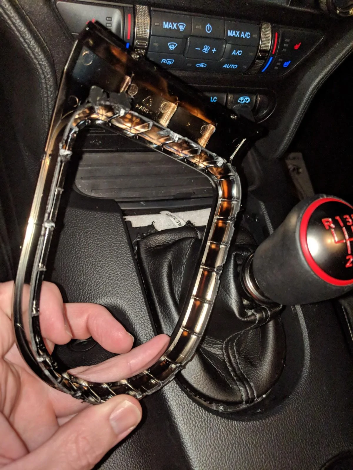

My confidence falls when step one goes wrong. Step one of the dash removal is removal of the shift knob and boot. You are suppose to lift from the front, and get far under it (near the SYNC word) to lift the plastic and get the clips to release, NOT THE METAL RING. Once the metal separates the only solution is to glue it back on, which is crap obviously. I will make them give me an entire new shift boot cover, it's only $70 retail so shouldn't be an issue, but they broke it, so... on them.
