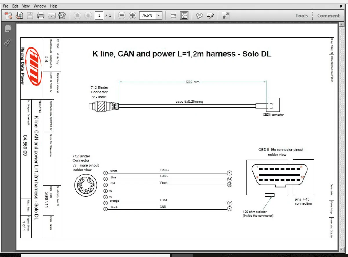

I recently bought a new SOLO2 DL. After plugging in the OBDII connector and Solo2 DL, my car would not start or even attempt to start, the dash lights would come on but no crank, nothing, the Solo2 DL is not plug n play.

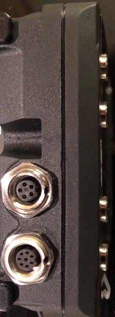

I borrowed an AIM OBDII cable/connecter from a friend at the track, plugged it into my car and Solo2 DL. My device seemed to work ok, at least the car started and I could see lap times during my weekend. The details of my friends "AIM" device was that his is not a Solo2 DL, his is an older Solo DL, (not a Solo2). His cable uses the other connector (the Solo2 has two cable connectors with different pin-outs), it turns out that I was plugged into the more generic connection (5 pin vs 7), so I did not have any data from my cars ECU.
After some pain and suffering, I found that the Solo2 DL needs to be configured via the "Race studio3" software. The software is used to configure the Solo2 DL to communicate with the cars ECU (ECU protocol).
See the picture of the two different connectors/pin-outs

There are 2 connections on the bottom. The one is for the ECU cable, the other is to connect a smartycamHD to the Solo2DL.
Yes, RS3 controls all of the configuration.

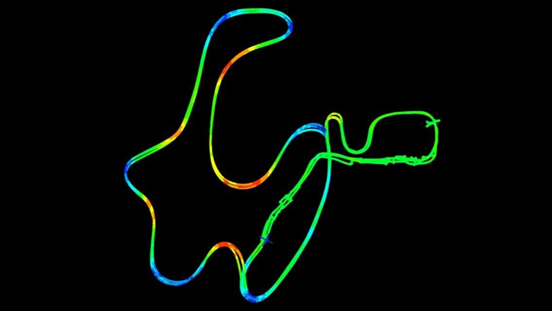

The track overlay feature is ok. This is a lateral G plot. I prefer an aggregated G plot; but, don’t have one handy. I have lots to learn and currently working on turning in harder and earlier.
