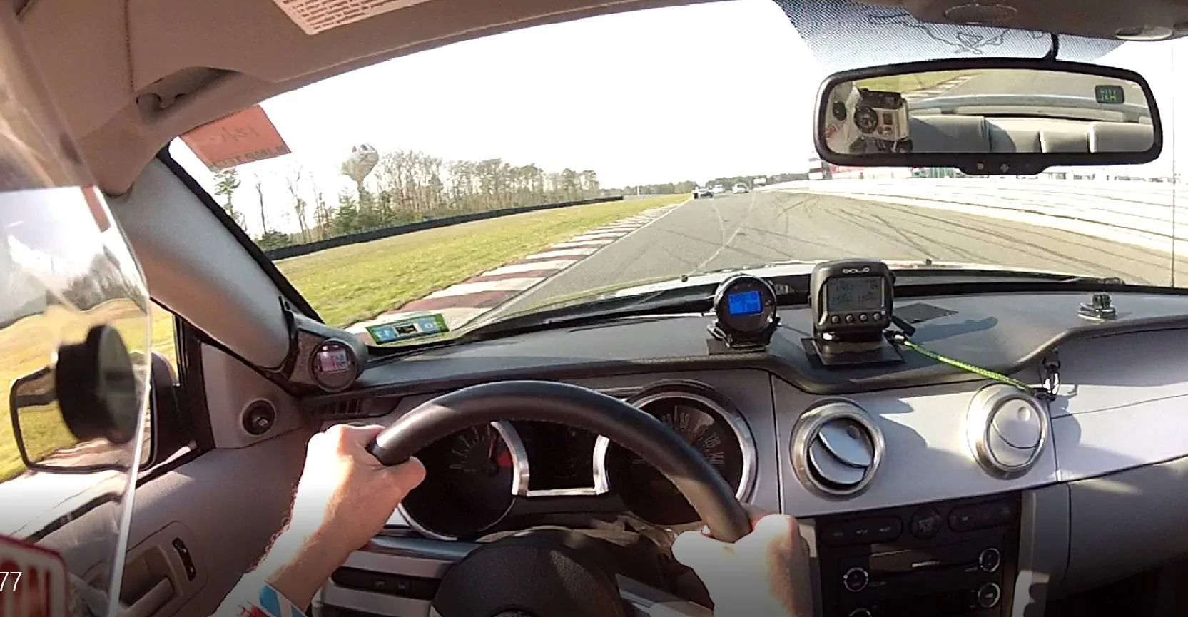

As near to the car's CG is probably best for the Aim unit. I mounted mine to a piece of metal that I bent to stand the Aim unit up vertically, and the bent metal is stuck to the dash using Velcro (and a pair of separate tethers). The Aim and the Aeroforce come off at the end of each track day. Also shown is my other camera mount.
As a part-time track toy I'm fine with it looking the way it looks.

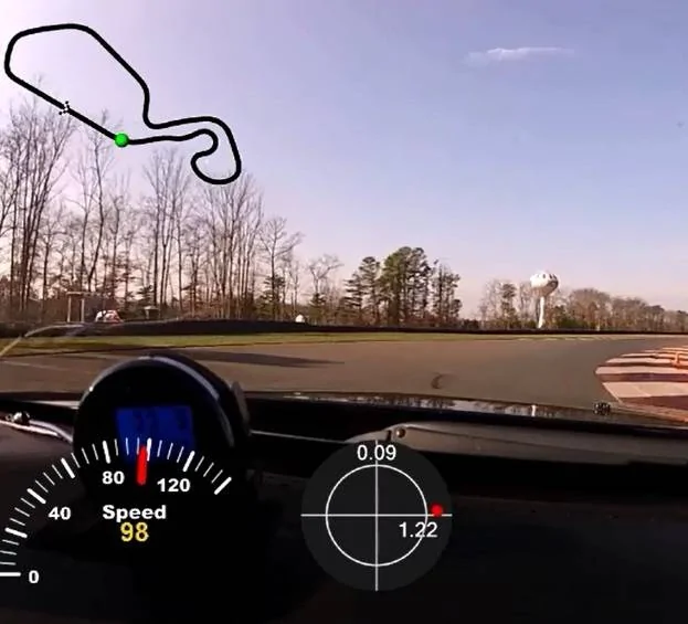

You'll want to use Race Render to overlay the data over the video. Spend the $50 and get the good version.
