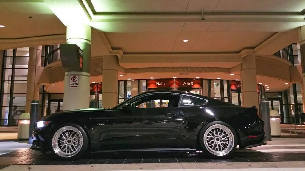

XXR 521 20x10.5 square. 275/35/20 Nitto 555extreme tires. Bought off a friend, I believe they're +30 offset. No rub lock-to-lock, will rub slightly in the front if I hit a big enough hole.

Is anyone running a 19x10.5" +30 on the rear with stock camber dumped on it's arse?
If so how much clearance you got to the lip?
Cheers.

I just asked a question about this with 19" diameter. Are you sure these are +30 rear? If so how much clearance?
