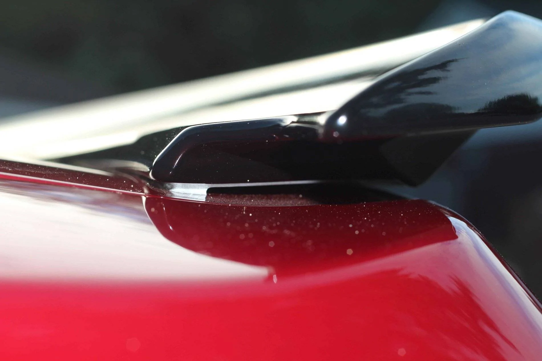

Well, I can confirm that the Speedform GT350 track pack spoiler does not fit the convertible. It WILL attach, after stretching the outboard holes and drilling new center holes, but the ends will not lay flush on the deck lid. It leaves a gap about 1/8" on both ends. Nice wing for the price but just doesn't work with the 'vert.
