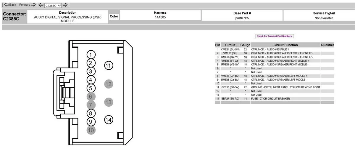

According to the wiring diagrams it is pin 9 of C2385B (color VT-RD) which is meant for the sub amp. Probably the connector is not there. There is a catch (actually 2). This signal needs to be enabled via programming and the signal is 6 volts only. Most amps need more than that.
Or you use the wire which is between ACM and the front amp (DSP) which is a blue/green wire and should be on pin 1 of C2385A. Same issue there it is 6 volts only.
Pin 1 is 6 volt. You need a Pac TR-4 to convert it to 12 volt.
The 12 volt and ground to power the Pac TR-4 are also in the same plug.
Amp will then turn on and off like factory.
Amp will then turn on like factory
Either that or any other step-up converter with a 12V ouput.
Other guys just used any other power source, which is hot in start or running like that camera power (blue/white if I remember correctly) mentioned before.
