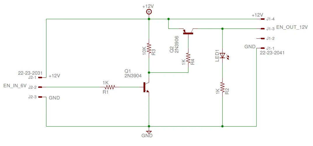

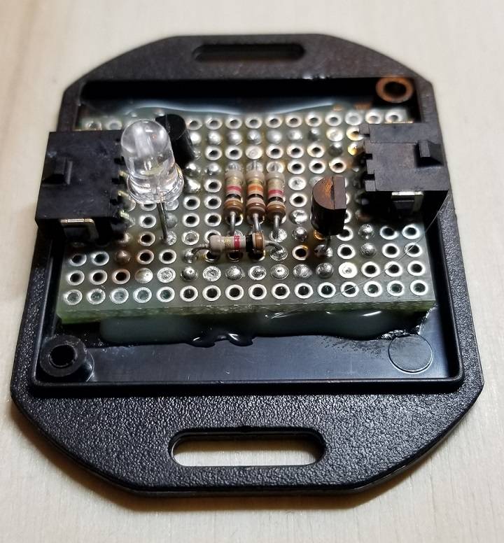

Agreed. I am going to leave it connected to the 6V enable line. I made a voltage converter that takes the 6V from the head unit and bumps it up to 12V because my DSP wouldn't turn on with anything less than 7V. Did some testing and I think I have my startup/shutdown timers in my DSP setup nicely now. No pops that I can tell.
High side switch 6V to 12V converter and schematic. LED shows when the system is on.
