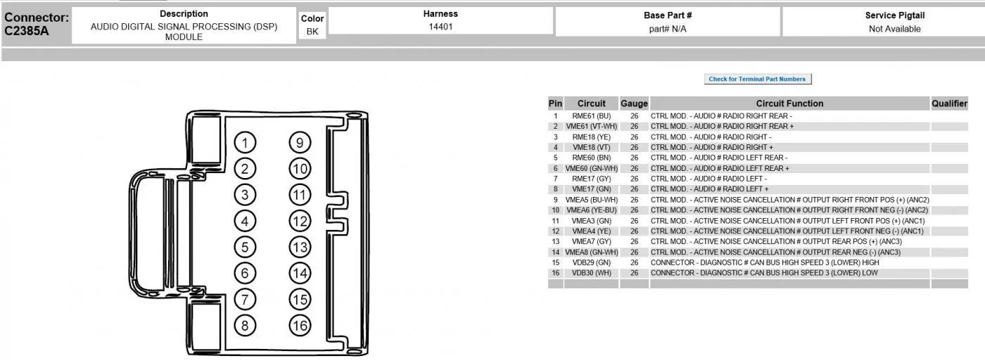

I am installing an amp and speakers to replace the front sound stage for my base audio ecoboost.

So it seems that connector C2385A has the signals that I need to feed to the high-level inputs on my amp. But I have 2 questions:
1. Where is this connector physically located?
2. How do I use the referenced molex connector (34690-0161)? I need to get RF+, RF-, LF+ and LF- to my amp, and then get my amp outputs back to the original circuits (using existing speaker wiring). Can this all be done using just this molex connector or do I need the others that are mentioned?

Typically, for "no-amp" systems, I always pull signal from directly behind the radio where the signal is strongest (cutting the OEM wires, capping them, and taping them away to be re-soldered should I choose to go back to stock), then route the signal with "9-wire" back to my processor or whatever you're going to use to convert the signal into your amplifier (some amps have LOC's built-in). You do not need to use heavy gauge wire to bring the signal back to the amplifier - just no smaller than what the stock wiring is, probably 18 or 16 AWG COPPER wire.
I would figure the connector you're talking about is the one that connects to the back of the radio, as that is where the signal is should be amplified for base radio speakers.

I believe the plug you are referencing is for the Shaker 9/12 speaker systems and not the "base" system which you say you have.
I would suggest IM'ing user OEMradio on this site as he probably has the plug/pin info you need... trying to save you a few bucks :D

OEM is now selling/shipping a harness that is a direct plug in. Nicely put together unit. It will allow easy access to grab a speaker level signal and also tap directly into the speakers them selves. The big plus is if you use his program to go to line level the rca's are paralleled the speaker wires. The best option for the base unit that I have seen. Also the base units plug is a different form factor than the one above.
