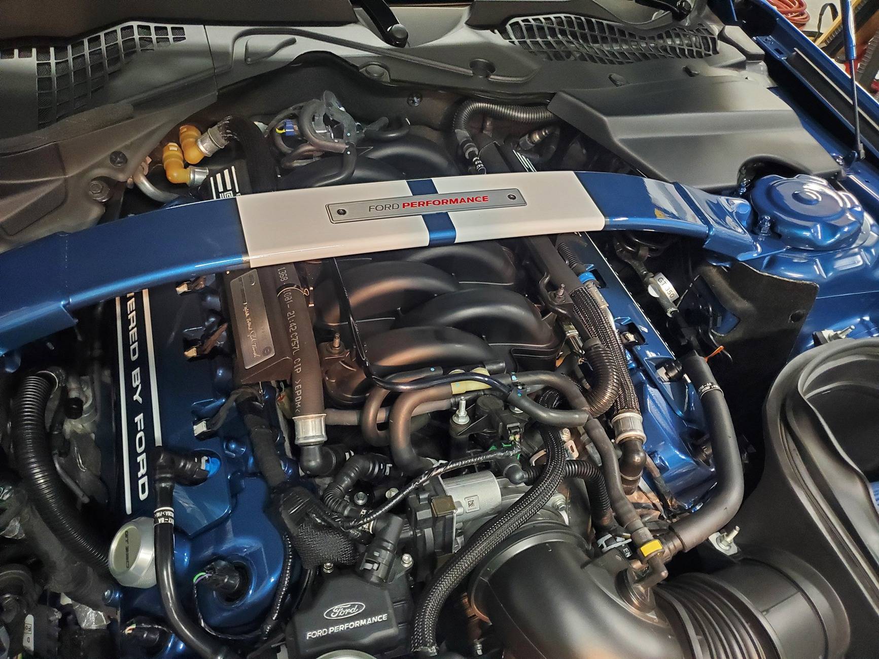

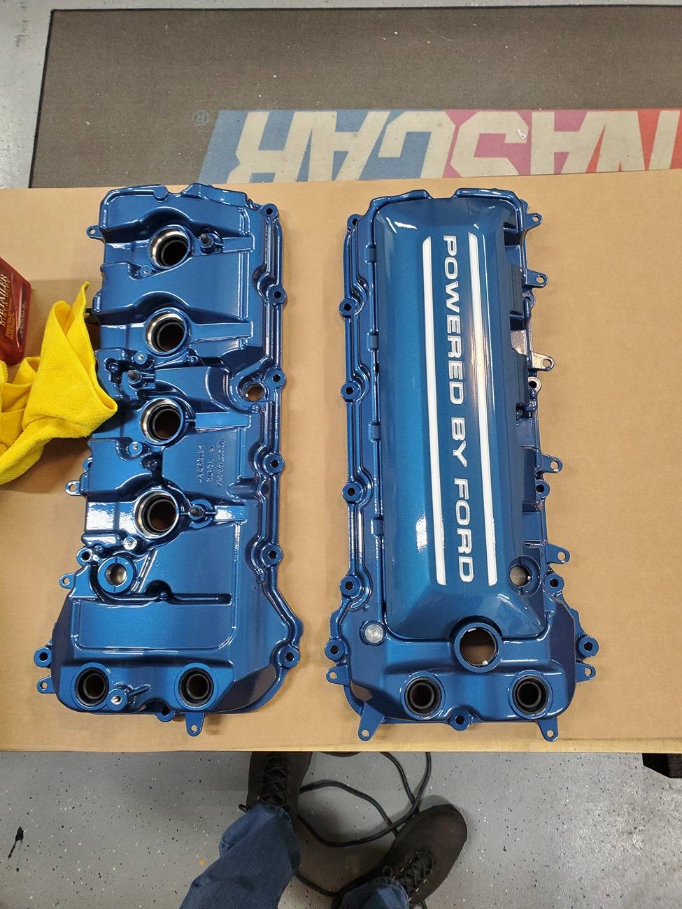

That is why I opted for paint over powder coating. My painter was able to cover them.
Yours are painted? They look great, would have bet on those being powdercoat. I was thinking perhaps high temp paint as a second option..now perhaps even more 🤔

Yes, matched to the vehicle. The painter said heat would not be an issue. How hot does car finish get in the sun?? 2 years and no issues so far.
Very true, and those really came out beautiful i must say! Thanks for posting the pics 👍🏻
