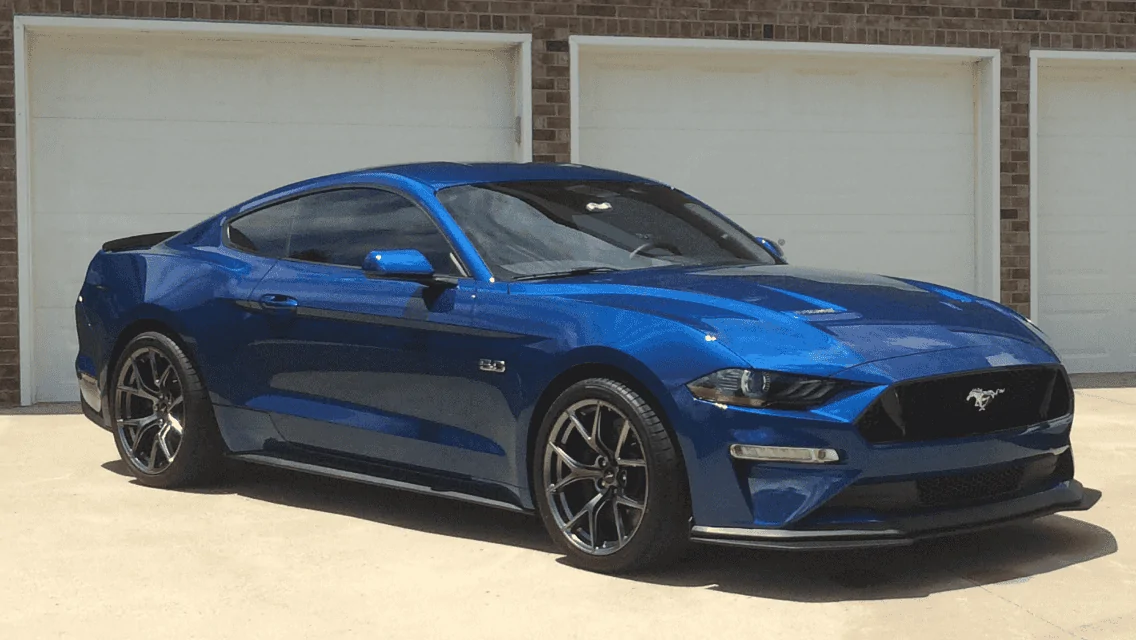

If you’re looking for a nice weather/weekend car to also be used for a few track days, you might consider a 2018-2020 PP2 car. That is exactly what I wanted and my ā€˜18 GT PP2 fits that bill perfectly. I switched to a little less aggressive summer performance tire from the stock Michelin Sport Cup 2’s staying with the stock 305/30/19 square setup. Car is amazing on the streets and fun on the track.
I’ve never experienced some of the rear diff overheating issues some with a more aggressive tire have reported. I’ve run 15-20 minute sessions in 70-80 degree ambient temps with no issues. It certainly gives up some of the performance capabilities this car has in stock form with a little less aggressive tire, but it’s still capable of delivering.
I’m at 18K on my car now with zero issues. It’s been tracked about 1/2 dozen times now and made about 15 or so 1/4 mile passes. I do run a set of 325/30/19 MT Street drag radials for the strip. The only mod I’ve done is a resonator delete H-pipe. With the stock active valve exhaust and the H-pipe, it’s one of the best sounding stock exhaust systems I’ve ever heard.
My car was a special order 301A with Recaros and active valve exhaust. I paid less than $39K for it in May 2018. I wouldn’t change a thing if I had it to do all over again.
