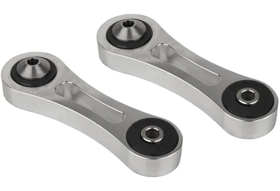

Steeda S550 Mustang Billet Aluminum Vertical Links with Polyurethane Bushings (2015-2019 All)
I would like to mention that these vertical links are maintenance free. Furthermore, they are used on our Championship Road Race car and the Delrin version on our record setting Drag car.
Featuring our all new polyurethane bushings, Steeda's S550 Mustang Billet Aluminum Vertical Links provide less deflection than the rubber bushings in the stock vertical links, but do not add any NVH.
Made from 6061 aircraft grade aluminum, these links will keep your S550 wheel alignment dialed-in and help keep the power planted to the ground. The larger polyurethane bushings, combined with billet steel sleeves and spacers, offer more control through jounce and rebound while still offering plenty of compliance, causing absolutely no suspension bind or an artificial spring rate.
Our one-piece billet design is accurate down to one-thousandth of an inch (0.001"). The S550 Mustang geometry requires a precise length Vertical Link (something not possible with a welded design), as a either a longer or shorter piece will drastically degrade handling and stability.
These Vertical Links are an excellent component for road racers, giving better stability under severe and high speed hard braking.
Can you please expand on this further?

Before we were first to market and released our billet "Delrin" vertical links we tested welded versions as well as adjustable units. What we found was that even the slightly change in overall length cause bind and lead to an unhappy IRS. So even though it costs more to produce, at the end of the day we knew a precision billet CNC unit was the only way to accomplish this goal. We always want to produce the absolute best for our customers and put in the hard work to ensure this.
What is "slight"? 0.001" tolerance is not slight. Are you saying that +/- 0.25 mm from nominal is too much?
