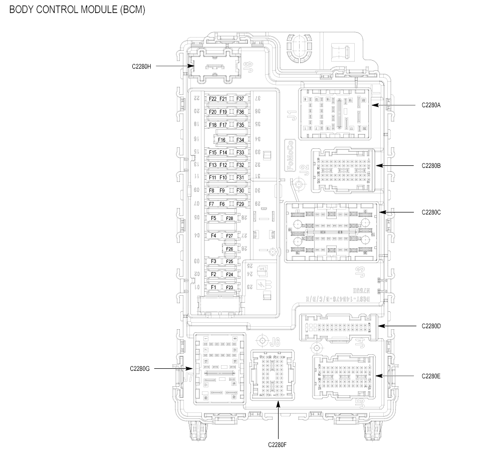

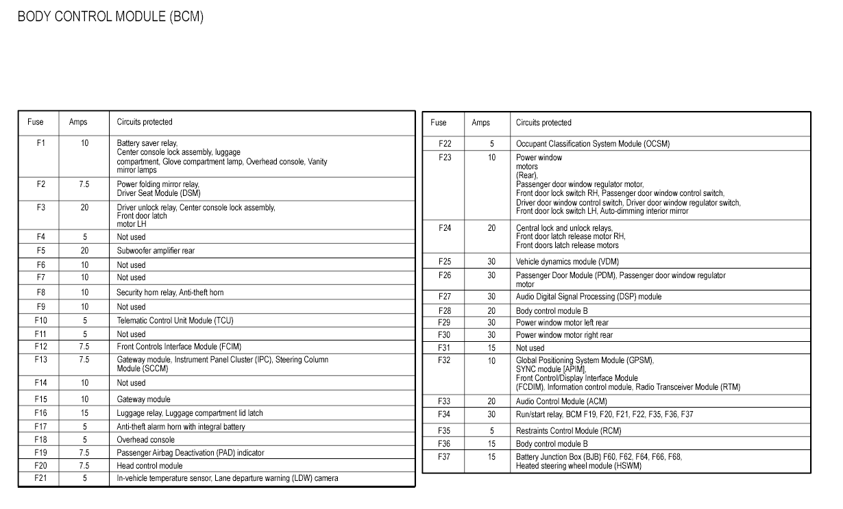

Fuse info for passenger kick panel from 2018 Helm Shop Manual
