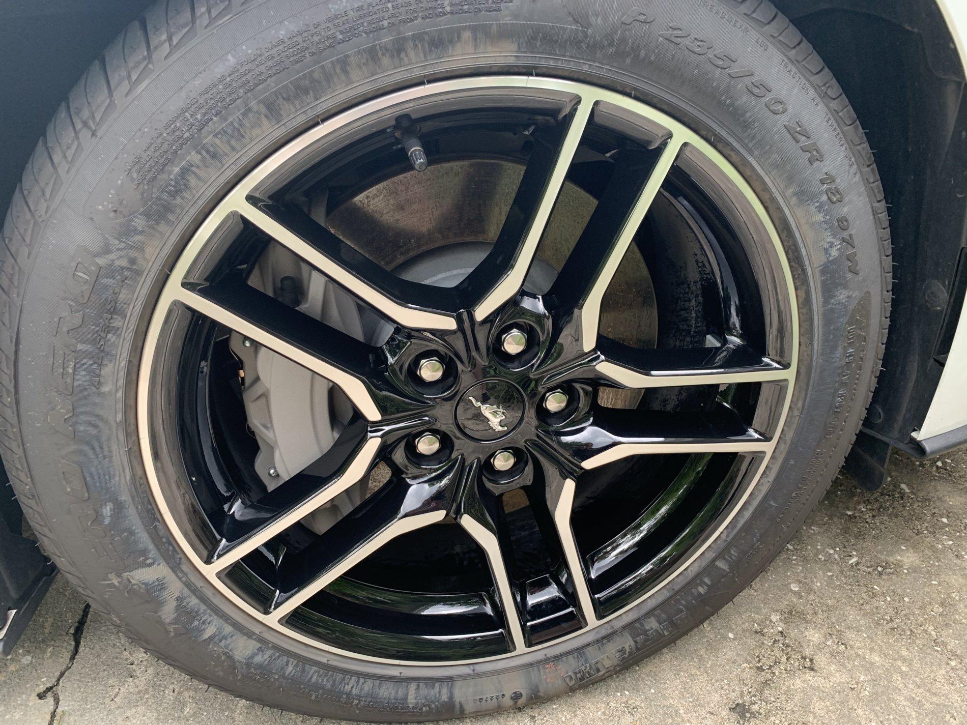

Picture for reference.
Again this wasn't a full wheel and tire cleaning then wheel and tire dressing. Just wanted to test the product on the wheels themselves.

Basically, you removed all of the dressing that was there, and the "blooming" appeared where you removed the tire dressing. Clean the entire tire with a good all purpose cleaner, re-apply your tire dressing and it will "go away."

Gotcha, new car so i assume thats either factory or dealer crap on there. makes more sense.

As per the info from the Adams website really. I scrub my tires each time I do the wheels. If you keep them clean enough, you'll only need to hit the tires once - takes less than a minute and you're down there doing the wheels anyway! Tires as per your photo you may need to hit them 2-3 times (rinse, apply cleaner, scrub, rinse). Top tip that has helped me - keep repeating the process until the foam you see whilst scrubbing is white, that'll mean the tires are free of all junk :)
