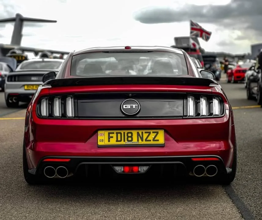

From the UK here, mine is a 2017 car. MP Concepts quad tip rear diffuser and 2018+ active Borla S-Type axle-backs with a control unit and valve actuator kit from Aliexpress that plugs into the 12V socket and is operated by a remote that gives you fully open, fully closed or an "auto" button that just opens the valves in 25% increments. The wiring is pretty much completely hidden under the back seats and behind the trim pieces inside the trunk in mine except for the tiny bit coming out from under the seats up to the 12V socket in the arm rest so it looks pretty much factory. You have to get the springs that sit between the valves and actuators either from a breaker or do what I did and buy 2 of them from your local Ford dealer, part number JR3Z-9449-A. A friend currently has a Bullitt system on his car using the same diffuser and actuator system. Works very well and before I added headers to mine the axle-backs and H-pipe were quieter with the valves closed than the stock 2015-17 catback. Valves open much louder, very useful for keeping the neighbours happy. Cost is obviously dependent on what system you choose to use, stock active catbacks will I'm sure be somewhat easily available from breakers in the US but a brand new system from brands like Borla or Corsa will cost significantly more. My axle-backs were nearly £1800, not sure what that is in USD but all Mustang parts cost more over here. Any questions feel free to fire them over👍

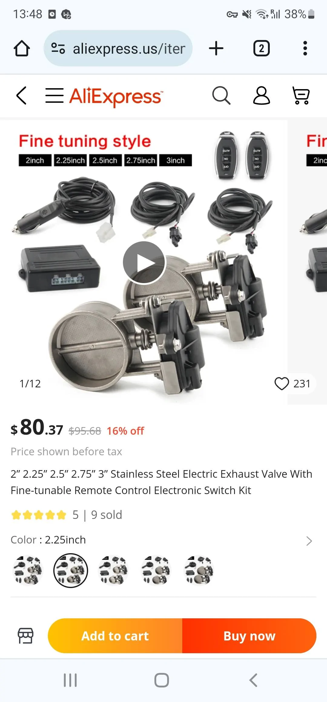

This was the control kit I used, or at least it looks exactly the same. Just order the 2 inch one as it's cheapest and take the motors off the valves. The kit does come with some valve springs but they don't fit hence having to use the Ford ones. Have the control box somewhere inside the trunk and then you can slice a hole in a rubber grommet in the spare wheel well to run the wires through to the motors, make sure you use some good sealant to keep moisture out of the trunk and potentially get some plastic sheathing for the wiring under the car to protect it as the insulation on the wires with the kit does look a bit flimsy. You'll also need nuts that fit the threads on whatever axle-backs you've ordered to secure the motors, the ones that come with these are the wrong pitch and don't fit the Borlas. I don't currently have access to my car due to being away with work until the end of March so I can't get any pictures of how mine's fitted, but absolutely feel free to message if you're unsure. The Borlas are ace, although obviously because the actives were never meant to fit on a 2017 car you do have to tweak the hangers quite a lot to get the tips sitting right in the diffuser. No cutting or anything, just a lot of patience and care bending the hangers to suit. Merry Christmas to you also!
https://www.aliexpress.com/item/3256801771199004.html
