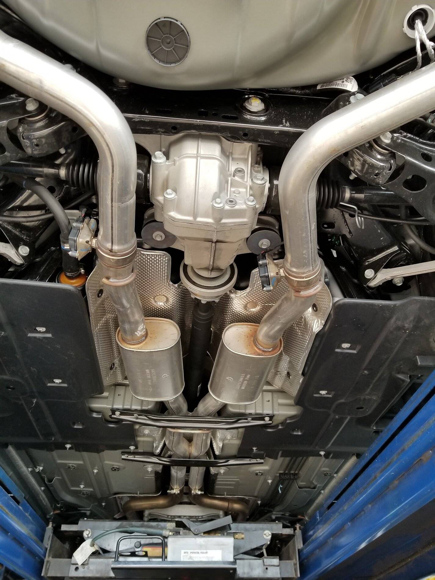

Looking at the prices of these active exhaust systems, I am curious, has anybody ever reconfigured their exhaust and put the active exhaust valve on a turndown before a muffler and then put a non-active exhaust muffler on their car, essentially using the active exhaust valve as an electronic cutout that are all the rage on old muscle cars?
I love my active exhaust, but it is not noticeably louder when opened vs closed to me.
Maybe it's a dumb idea, but I just can't justify spending $1k plus for a good sounding active exhaust when I have a lift, was a certified welder in a previous life, and sometimes have ambition to do things like this.
Any thoughts? Maybe these cars will sound terrible with basically open exhaust? Just an idea that popped in my head when looking at mufflers.

I prefer the way Dodge did their active system. Both the resonators and mufflers are pass-through. The active exhaust is just a restrictor plate attached to an actuator. This allows for relatively inexpensive "cut and clamp" style exhaust mods to go in without messing with the system at all.
That would be a cheaper for upgrading your exhaust, but how much power is lost with it closed? That is choked down quite a bit.
I think it could work to put a Y in right before the muffler and have it open into a turndown when the active exhaust is put in track mode, but would go straight into a muffler when not. I would bet the sound level increase would be quite noticeable for sure. Just not sure how it would sound.

In any mode, opening the throttle opens the valve. The rate just gets more aggressive as you go from Street to Sport to Track. At WOT, it's open fully no matter what. No power loss as a result.
As for your idea, I'd do a test run with the mufflers completely off. If you like sound, go for it. It would probably make sense to have the valve not fully open until at WOT though.
Yeah, I knew it was full open at WOT, but. I may give it a try at some point, I was just curious if anybody had thought of it, or if anybody had tried it.
