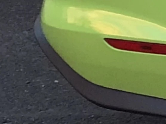

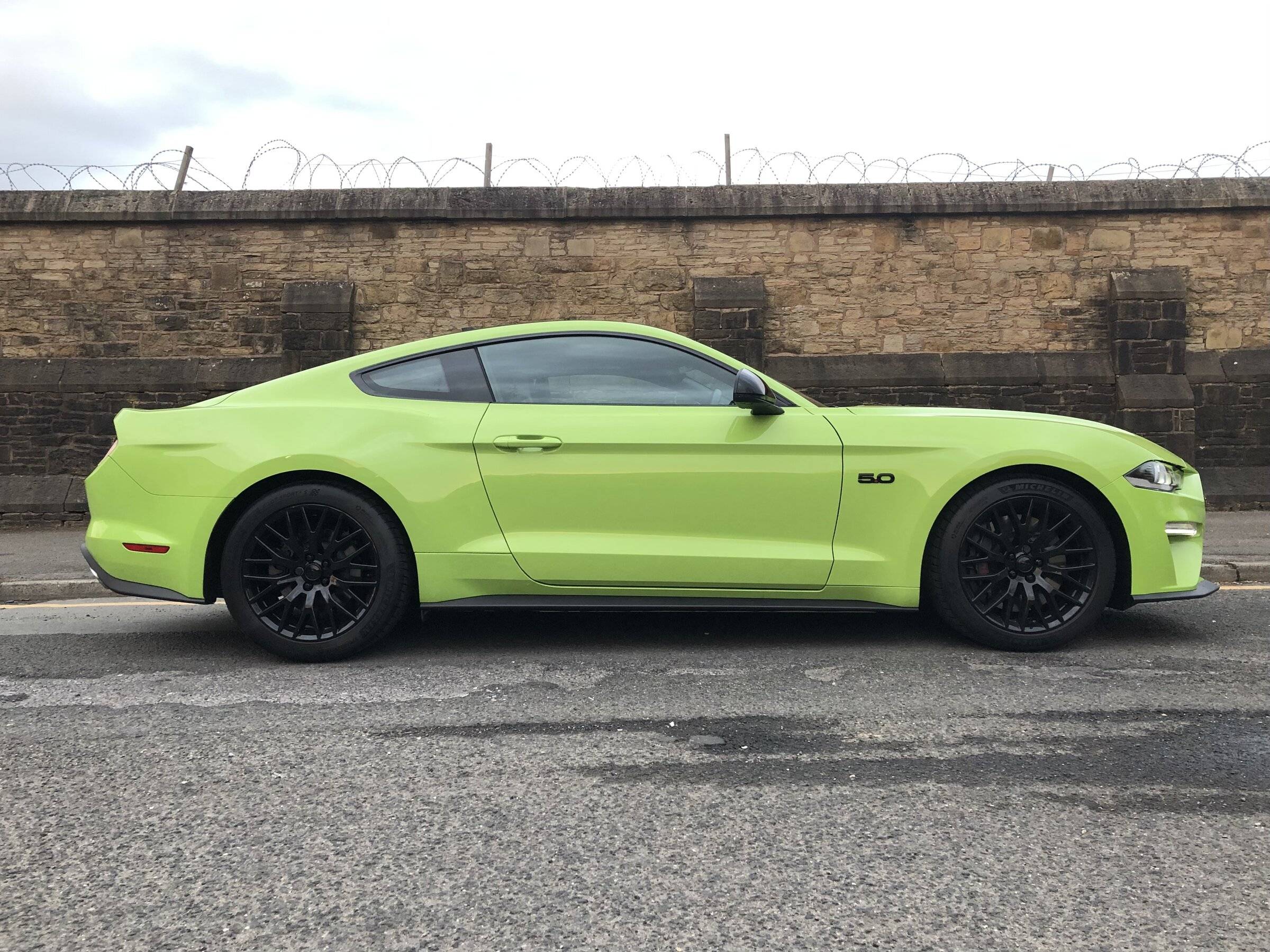

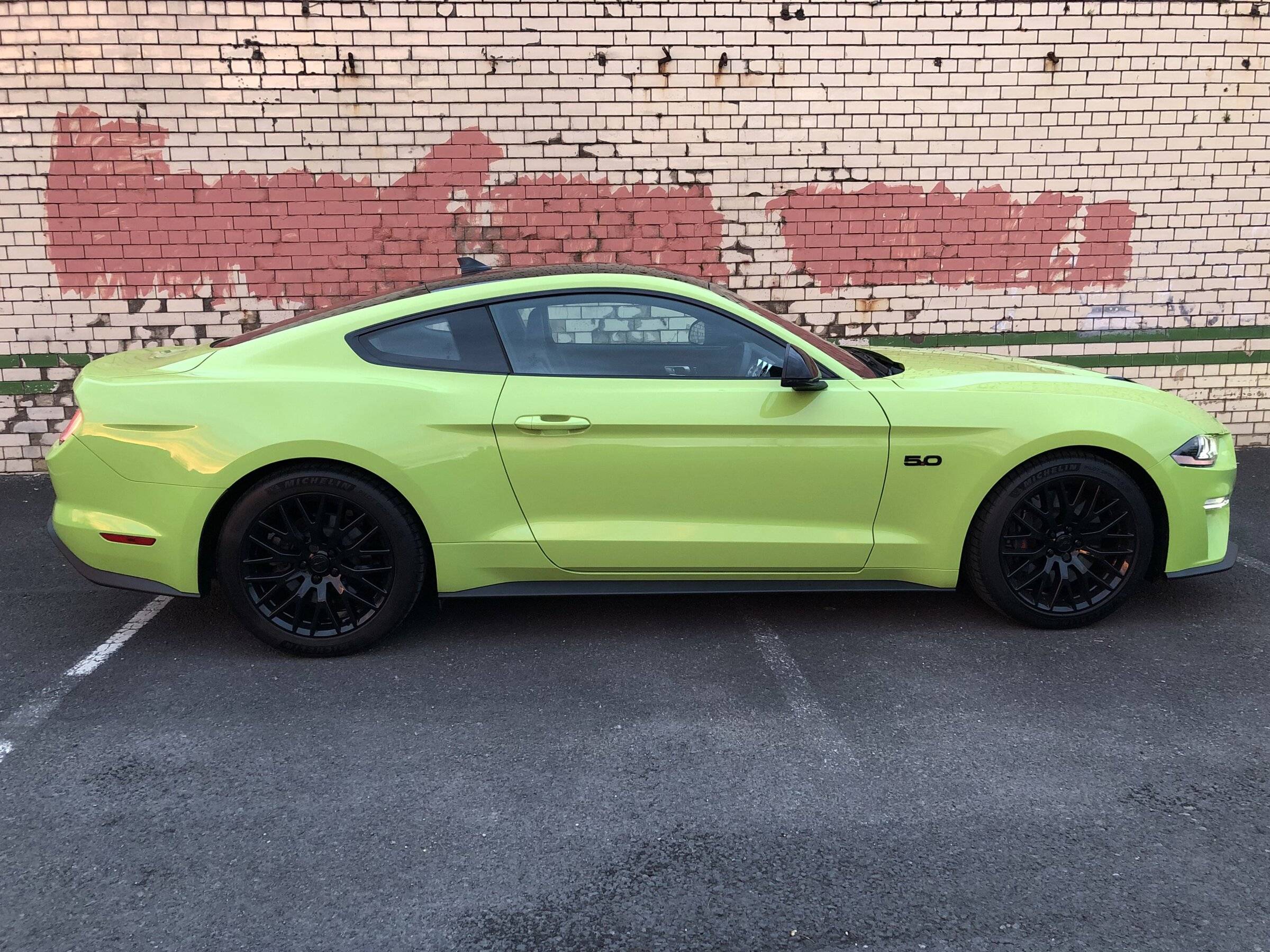

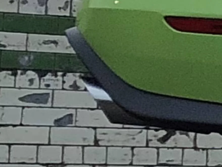

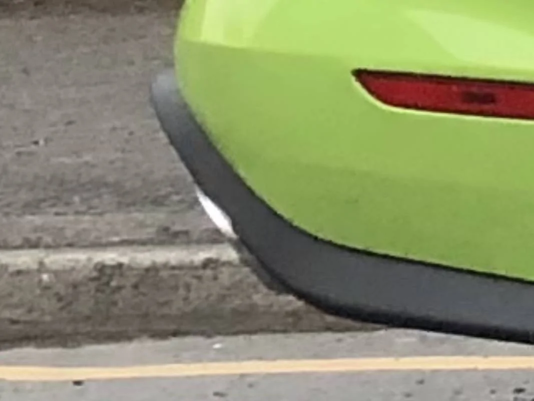

For those of you still with the standard AE rear end, how close are your tips to following the profile of the rear diffuser ?
I have a bit of a theory that the tolerances on both the exhaust fitment at flat rock and the exhaust fabrication vary somewhat and I’m looking for second opinions to back that up.
We know that if you fit replacement parts to the system there is a chance that if you increase the length by even a marginal amount it ‘might’ cause the loom rubbing issue.
We also know that some cars have suffered directly from the factory.
Now admittedly I’ve only been under mine on a cold (ish) engine and on a stationary car, but I seem to have a reasonable amount of clearance between the loom and body.
But here’s the the thing, my tailpipes seem to be well tucked under the valance compared to some cars I have seen ?
My exhaust is completely stock in these pictures and with my best guess at a straight on photo, my tailpipes range from being just visible :
To completely disappearing with a very slight change in photo angle :
So for those of you that have had the harness issue how does your standard OE tailpipe fit as a comparison ?
It might be good to judge the profile compared to the valance (you can see how ford choose to match the profile - a reason I have been resistant to change the tips). This low down angle shows it well :
