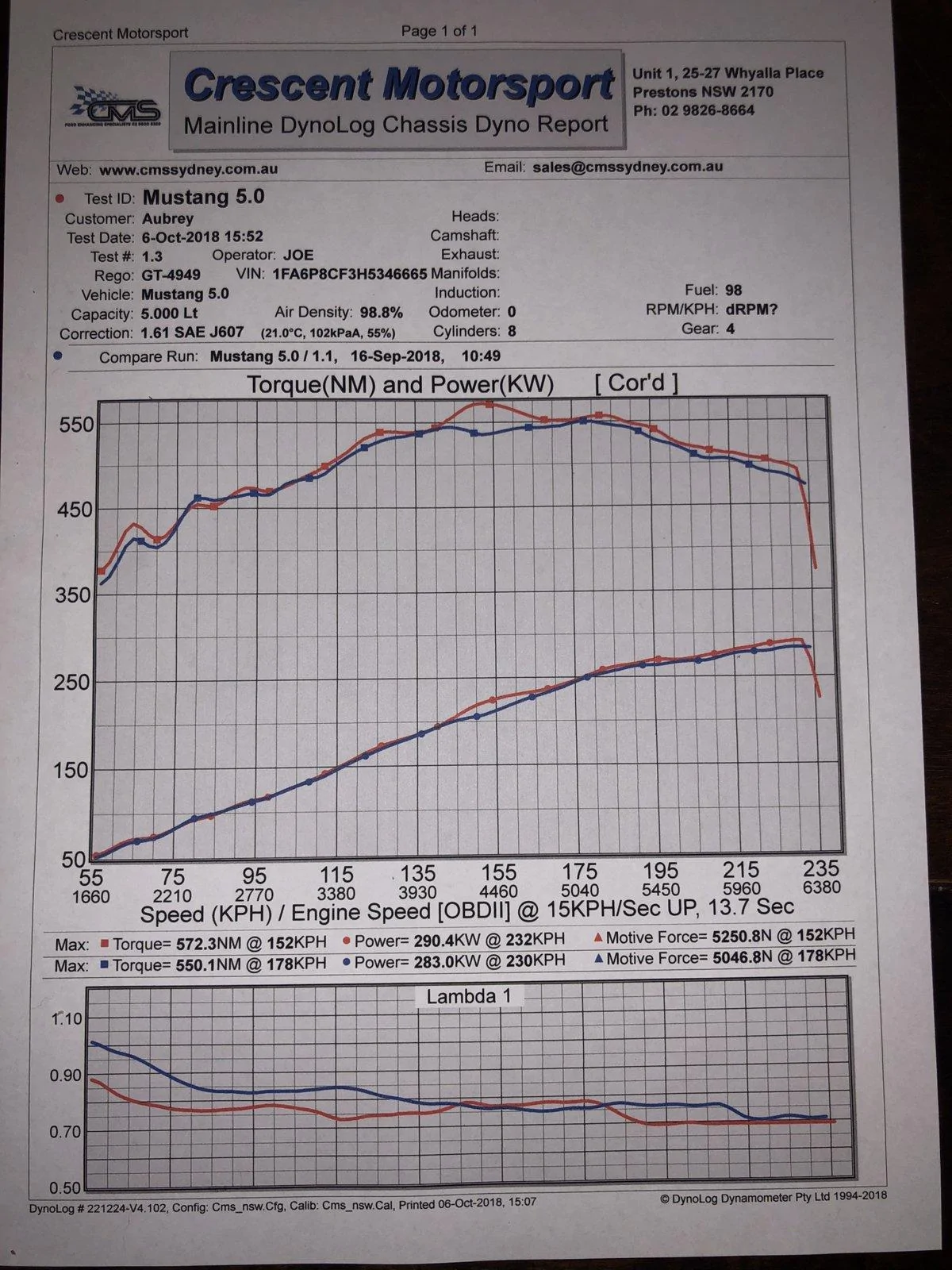

This is the feedback from Ford:
“No issue with the calibration. The issue is that the calibration has no lift shift. When they are shifting they are hanging their foot on the clutch activating it. Tell them to take their foot off the clutch completely when shifting.” I’m not so sure this stacks up.
I’ve now seen two before/after comparisons of the PP2 on 2017 GT, there is a minuscule improvement in overall power. One of them is mine and I’m no longer happy. I’ve requested an updated calibration file, but not expecting anything at this stage.
I think another tune is the solution.
I’m curious as to why Joe stopped the pulls so early? Roller speed?
