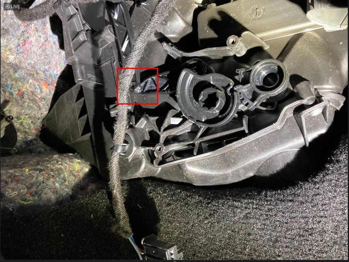

Yes, I was able to figure it out. There was no issue with any of the actuators. I had to buy a good bidirectional scan tool to diagnose the problem, and as a DIY guy, I kind of needed it anyway. It took me about two hours to identify the real issue.
Take a look at the attached image. The actuator connects to another arm (see the marked area). That arm had snapped off at the connection point. However, unless you remove the actuator, it’s very hard to notice. This actuator is located on the driver’s side.
