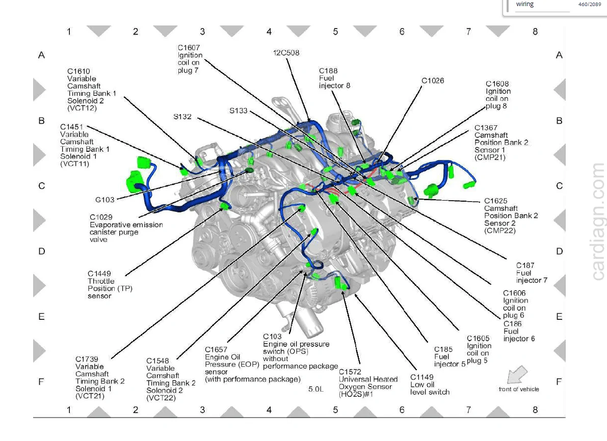

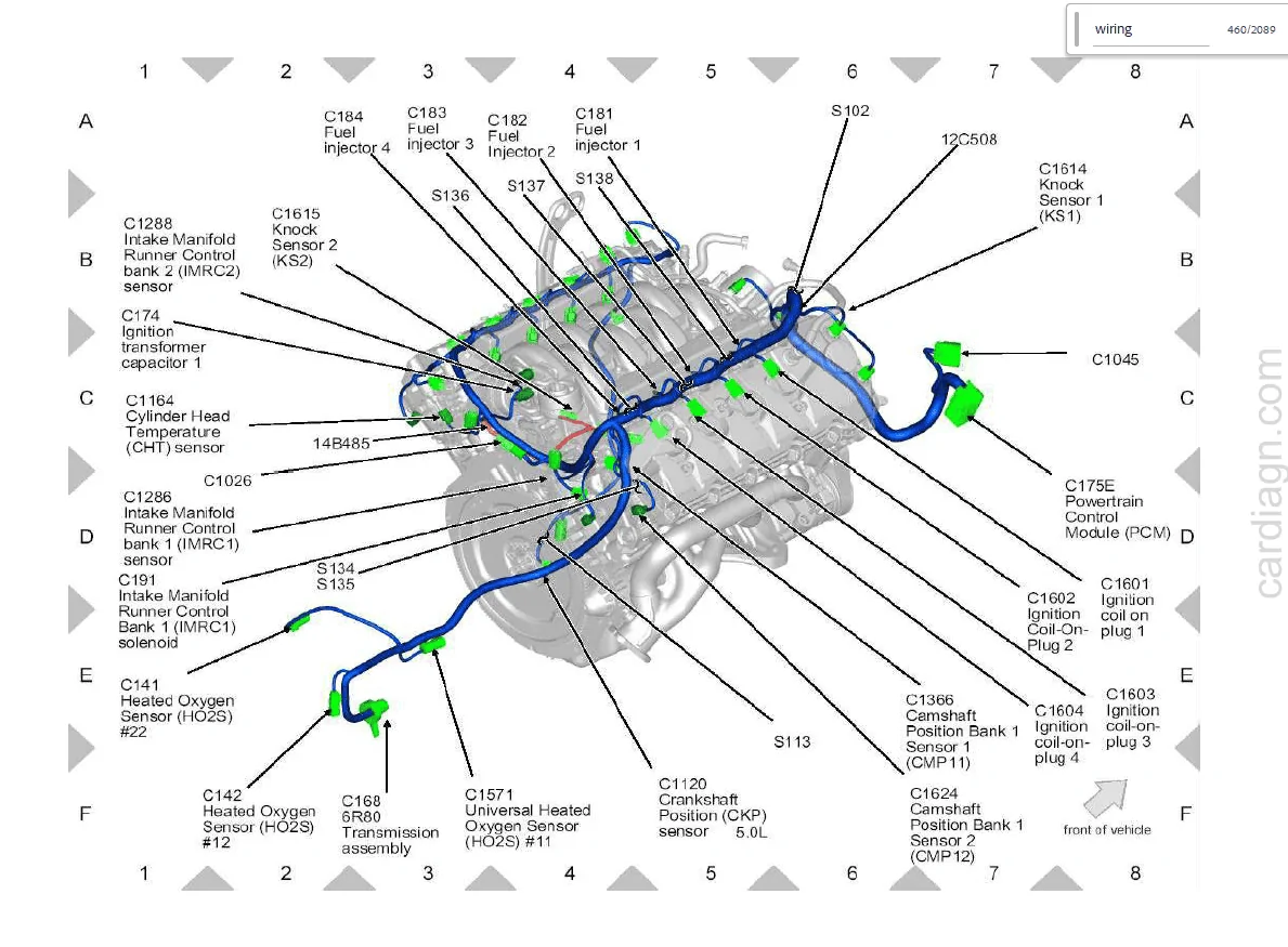

Stock manifolds or long tubes? I'd be looking for a chafed wire, or loose/poor ground

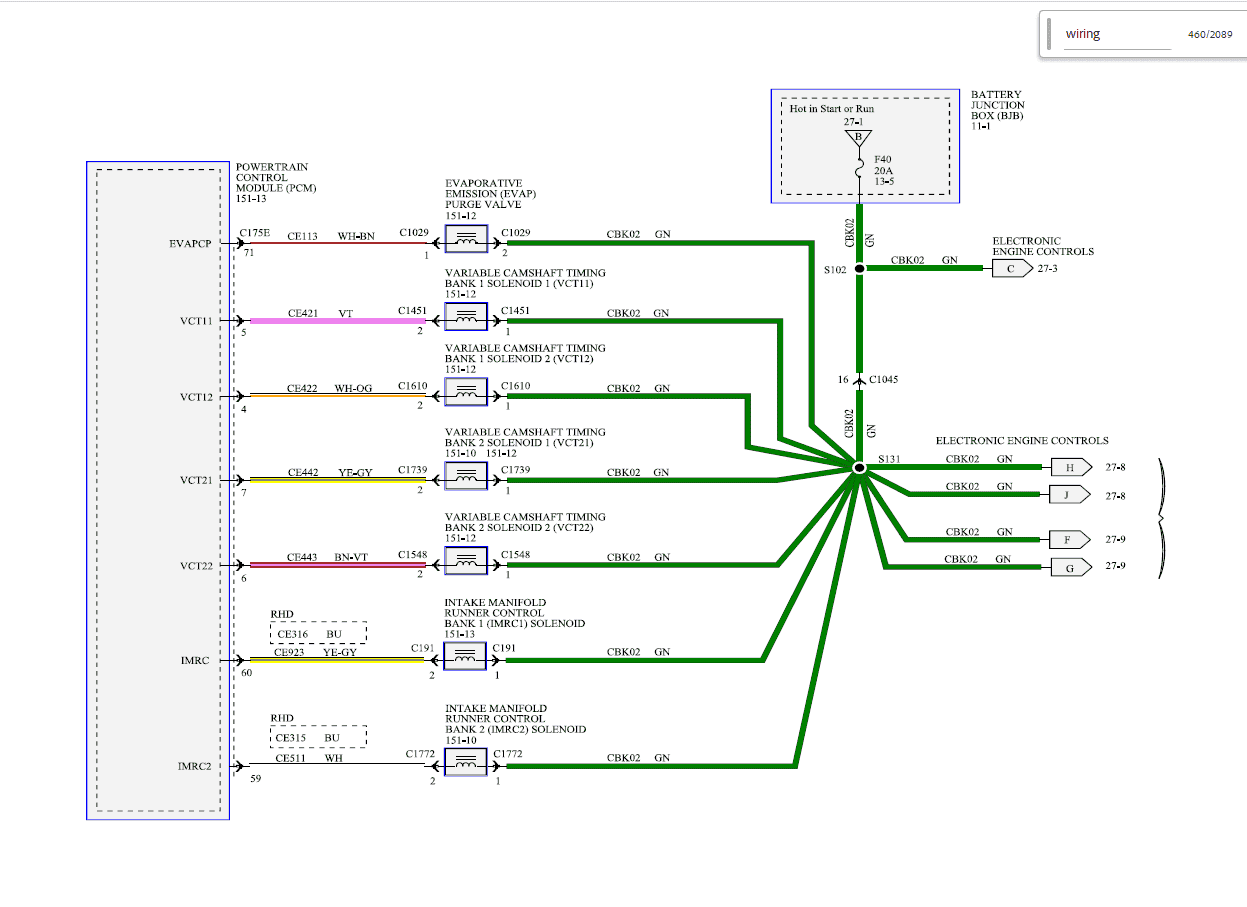

EDIT: engine bay fuse 40 (vehicle power 2) definitely overheated on one side (looked burnt), didn't pop. same with fuse 38 (vehicle power 1), but to a lesser extend

If you are getting a blown/melted fuse, you have a resistance problem. EIther in one of the connectors for an O2 sensor, the cam positions sensors, Purge valve, IMRC, or the component itself. Unplug each connector and ensure that they do not have corrosion in them, water, dirt etc. or a pin that is bent or pushed out. If you dont find anything there, start looking for wires that are shorting to ground, been chewed by vermin. Inspect the main harness grounds for corosion or loose connections.
It is possible for one of the items on that circuit to be shorting internally as well, but start with the obvious checks first.
The least likely scenario is that the PCM shit the bed

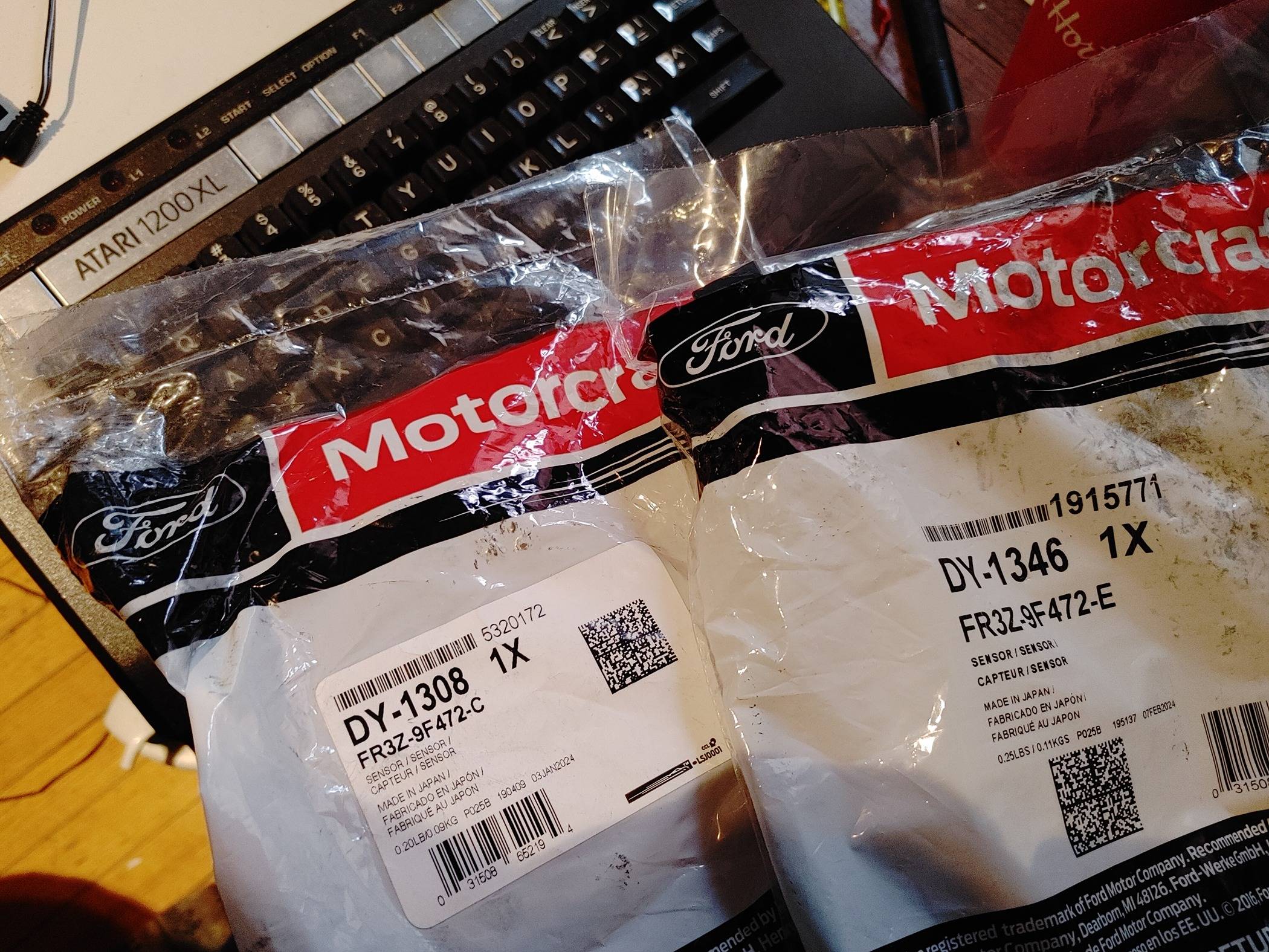

Thanks. Doubt its the PCM as it starts and drives just fine. Burns more rich though. Especially at idle. I ordered both upstream o2 sensors.

I'd still be looking for a bad/poor ground, or a connector that has water in it, or a bent or pushed out pin that is making poor contact. The 5v reference isn't what is burning and melting your fuses, and since you said that fuse 38 and 40 look unhappy, I'd be looking for a common ground that is bad.

Cleaned all the grounds. Got my O2's today. Put me in and see what happens ?

Haven't put them in. The pass side ain't happening without dropping the starter and/or exhaust. I did noticed the long terms are adjusting however.

All the cam sensors, EVAP, O2 etc, are good. checking resistance from each connection to the #40 engine bay fuse yields zero resistance.
