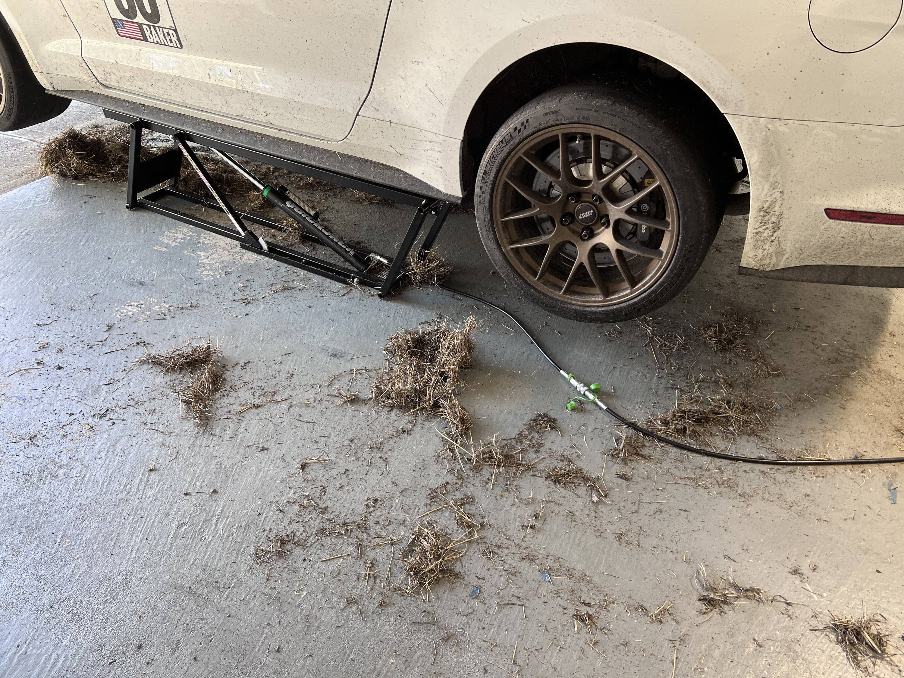

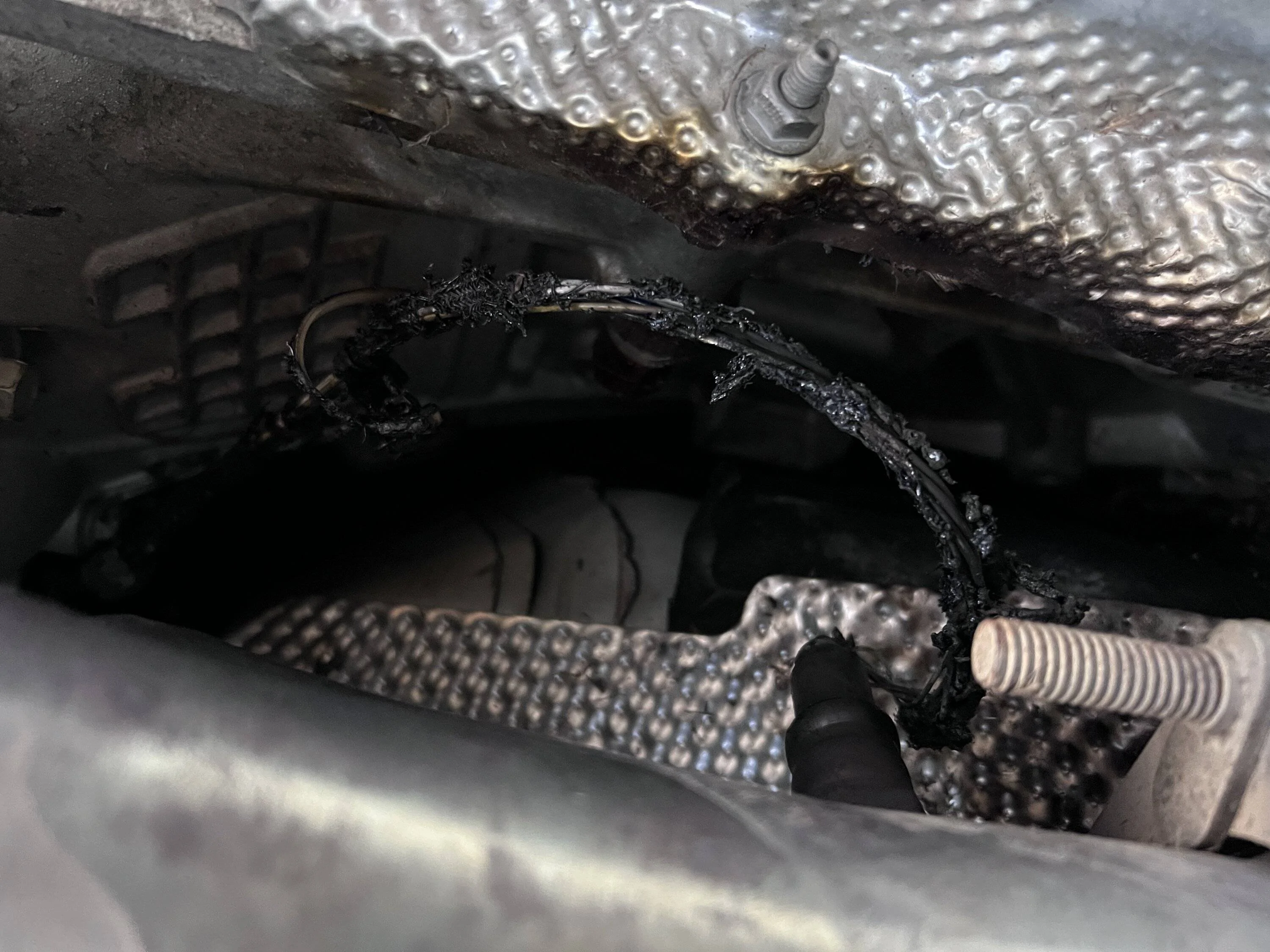

In case y'all are wondering if you get similar codes :
engine bay fuse #40 -> power to VCT / up~down stream o2 / EVAP
Thank you!!! Went off track today in the wet and these pulled up. Had wet grass fire and burnt the afr sensor wires. Replaced sensor still had codes. This fixed it. Love this forum!!
