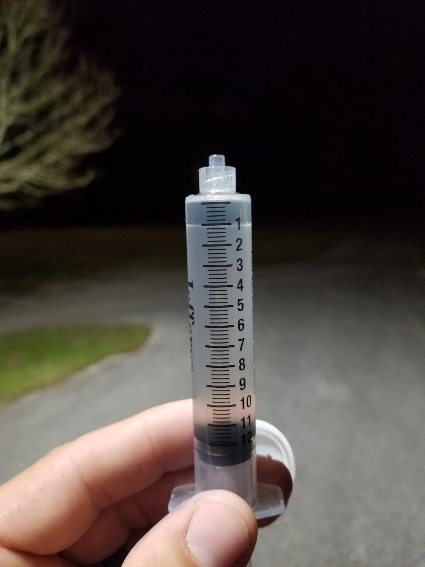

FruityJudy
Nov 13, 2018
877
766
South Alabama
2018 Mustang GT A10
So I cannot get my nguage to give me a reading higher than 67.1 on the FF tune. AFR on dash is around 10.7 at idle. This is 4ml water, 8ml E85. Separation line at 1.0. I added 5 more gallons and let it relearn and still locked in at 67.1
