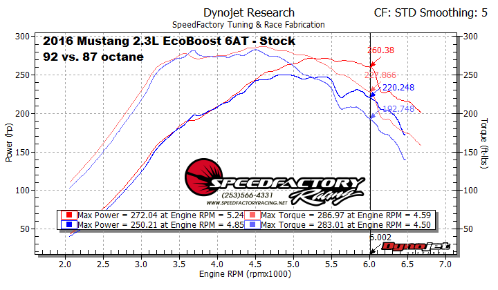

Dyno numbers are pointless. Would they embellish about making max torque on 93 oct? I think not. They would have to claim max torque on 87 oct to embellish. Bottom line, if the stock tune can add more power, 93 oct will let it find it. 87 oct may find it as well, but not for long.

The answer is yes, our cars will make more power on higher octane fuels. However, normally aspirated motors reach a point where too much timing can actually hurt power. So you may not see a big difference between 104 octane and 93. The control strategy was known as adaptive spark control and it's been around at least since the first gen coyote. 2018's are probably even more advanced in their tunes. Quote below taken from this article. https://www.autoblog.com/2009/12/28/deep-dive-fords-all-new-5-0-v8/
"Even without using direct injection, Ford was still able to achieve an impressive 11:1 compression ratio while allowing the engine to still run on regular gas. According to Harrison, a lot of effort was expended on the engine management system. The adaptive spark control system keeps the engine running right on the knock sensor all the time, continuously adjusting the spark advance to avoid detonation regardless of the fuel used. The control system has a high bandwidth air-fuel control algorithm to make sure that it's both responsive and efficient. The 5.0 has also benefited from work done on the Fusion Hybrid by incorporating aggressive deceleration fuel shut-off. Whenever the throttle is released, fuel flow is shut off completely to improve efficiency."
