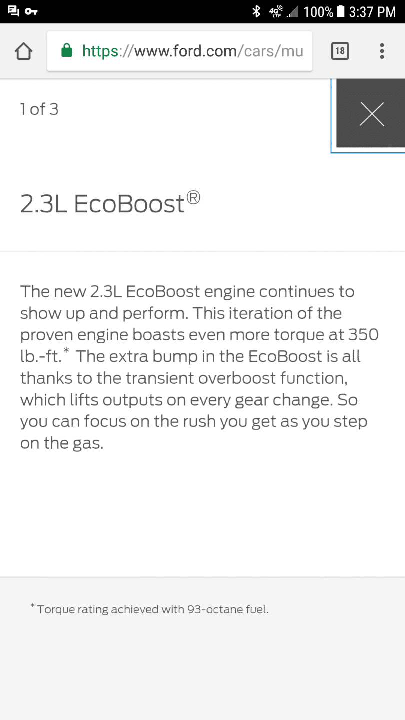

I highly doubt the stock Ford tuning tables account for anything higher than 91 - since 93 isn't available in every state. I very well could be wrong, and I hope someone who has experience with the stock Ford tuning tables / formulas would chime in.
Modern engine controls are highly advanced, even compared to say 10 years ago. A higher octane fuel (93 vs 87 octane for example) will produce different readings on the sensors and controls monitoring the engine. In other words, the computer will give the engine more total timing advance on higher octane fuel - thus making more power.
I do know from looking at two other manufacturer's tuning tables, they do in fact dyno / test with the full range of fuels (octane ratings) available to the market that tune / model is being released in.
