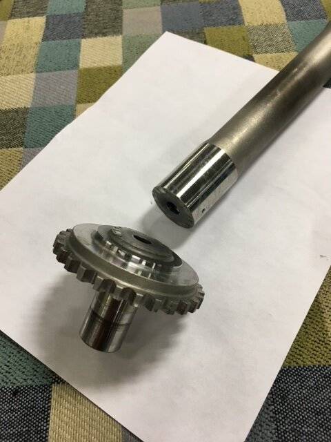

Intermediate shaft gear sheared off. It will look like this.

Curious what it takes to do that? How is the gear attached to the shaft? I’d guess it’s not one piece.

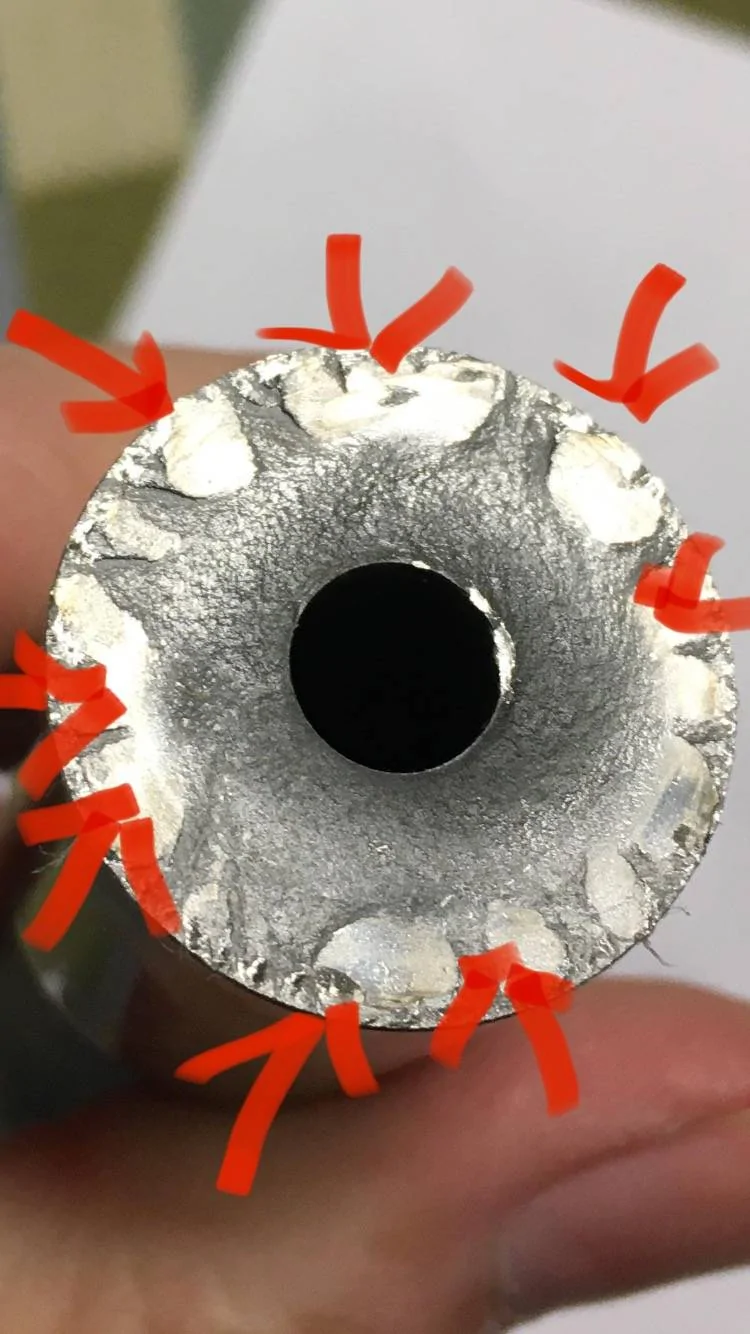

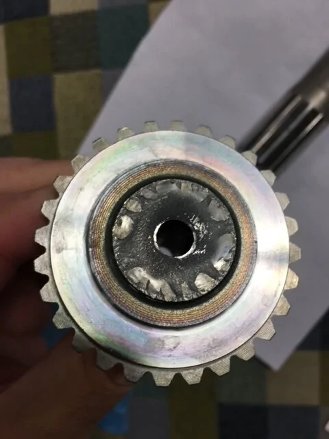

It's basically spot welded in reality. A tuner who sets shift pressures too high, will cause them to break much faster as well...... Aftermarket shafts are all 1 piece billet machined.
Here's where you can see the areas where the gear was fused to the shaft.
