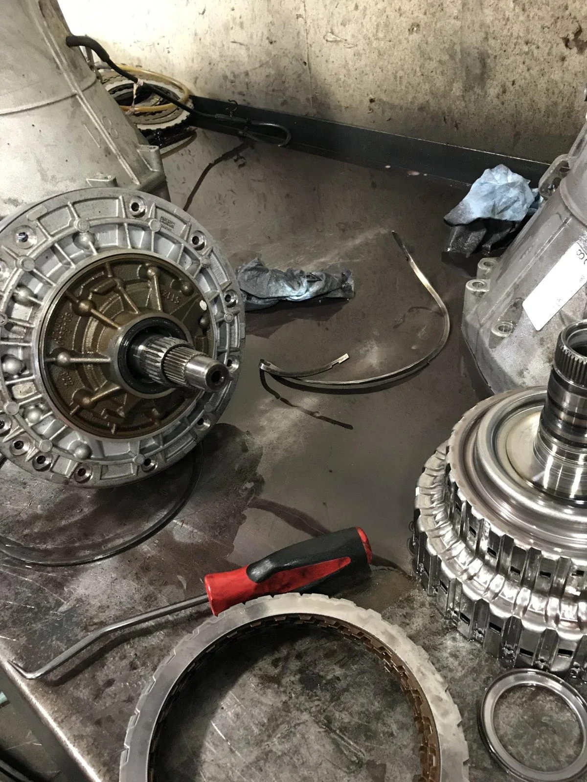

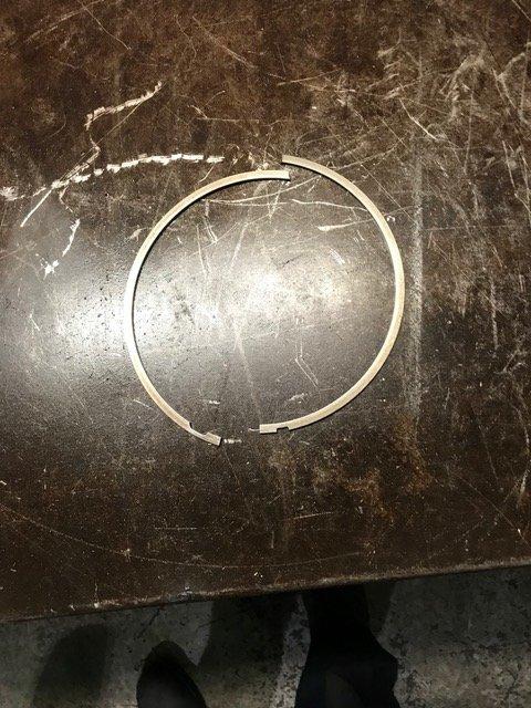

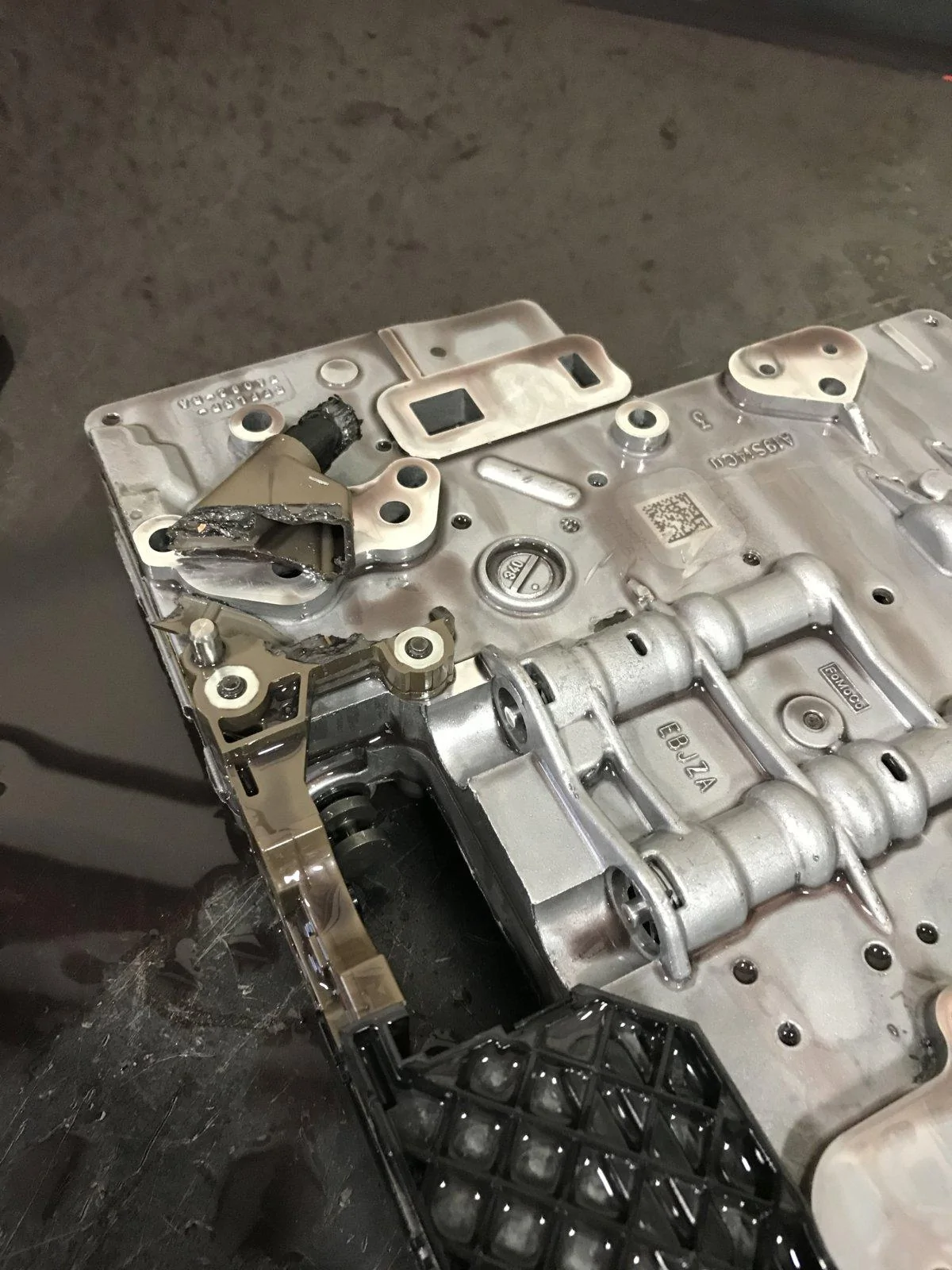

Results are in - 6r80 issue. Makes sense why the code for the sensor
Appears a snap ring decided to break and did some damage. Surprisingly the exedy clutches and billet intermediate shaft look fine.

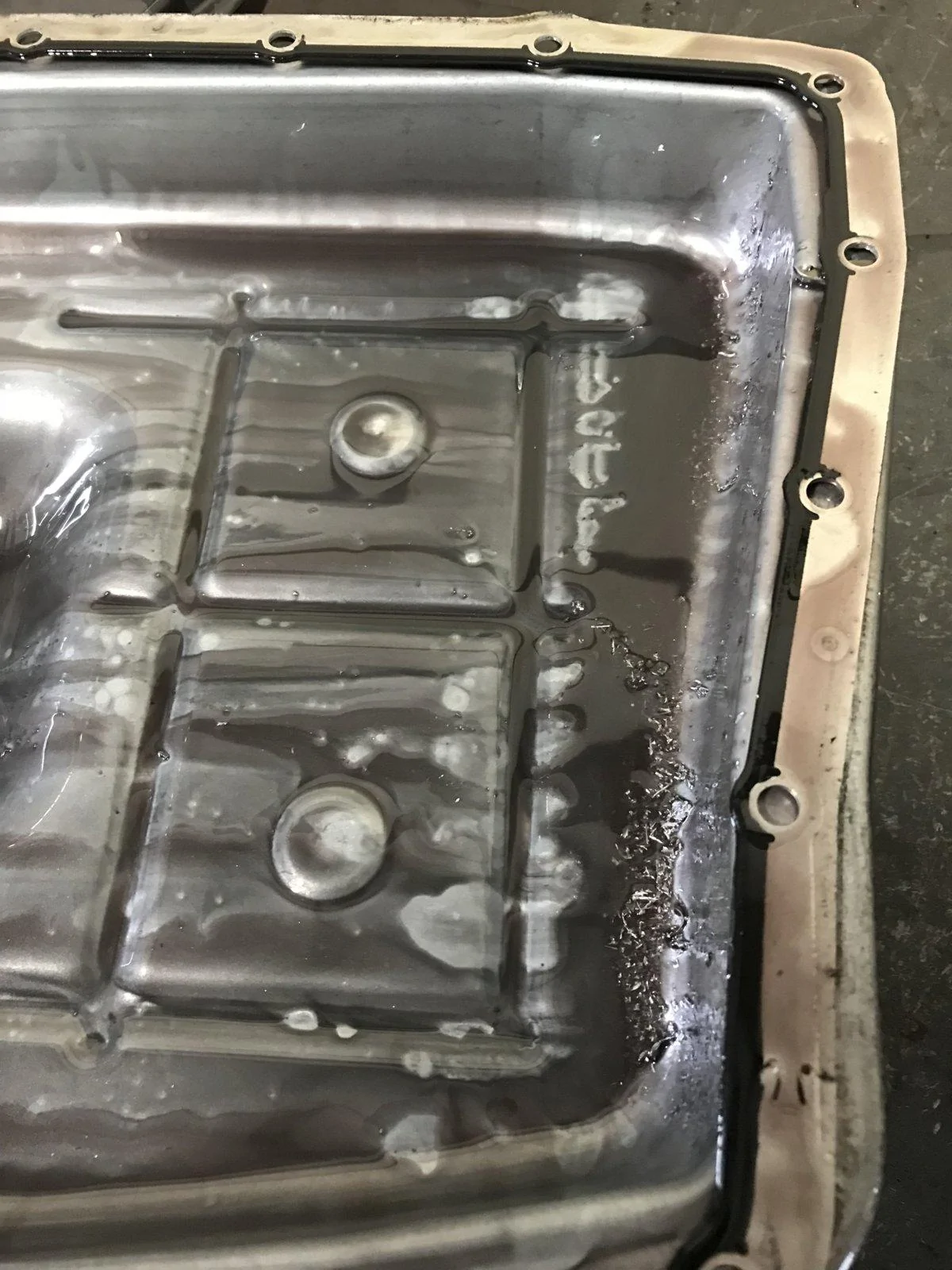

The fluid was NASTY.

First time I've ever seen someone else with a snap ring problem. Looks like the same one to me. Here's mine which snapped rather than twisted up like yours.
When this happened I lost reverse and had some erratic shifitng and noises. Shop described it to me as the snap ring holds all the parts together in the casing of the trans.
