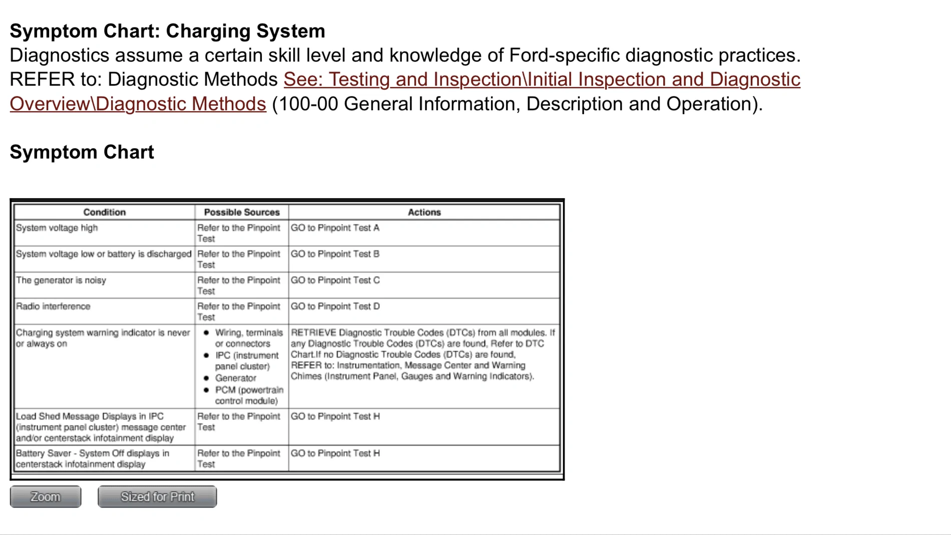

Sure. The light for "charging system service now" comes on repeatedly, randomly. It comes on more when idle than actually driving. There's about a 80% chance it'll come on at a red light or stop sign.
No issues with the car starting or any drivability issues. Haven't changed the battery yet, but it has not died in the 4 alternators that have been on the car. The voltage always looks normal as well.
As far as how I drive the car, I drive it pretty normal I'd say -- some spirited driving from time to time. I don't really drive at high RPMs for long periods of time. The most I'd do is stop sign to stop sign in first gear, which is usually around my office and it's about the length of 6-7 cars and only 3 stop signs. Not sure if that's considered "dangerous" or if that should be tolerable.

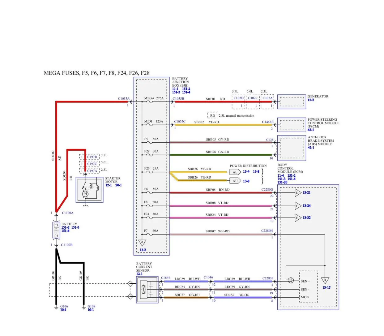

You have a wiring issue in the harness. I literally have replaced / repaired over 12 of these on F250-F550 trucks for the exact same issues.
They are wasting time and money replacing alternators. I’m surprised the dealers can’t figure this out.
It’s an easy diagnosis and repair.
That's what everyone was saying the first 3 times too. They finally replaced the harness on the 4th alternator replacement, but the issue still persists unfortunately.
Correct. But the harness / wiring GEN terminal to the gauge cluster

It's the computer that controls the charging system -- there's really no other possible cause especially since the harness was replaced. Depending on if you want to make the trip, I'm willing to bet the guy at South Main Auto (checkout the YouTube channel by the same name) in upstate NY could prove it.

Correct it does control it. But if the harness is bad or damaged it will throw the dash display. There is more than on wire. It tees off the trunk harness.
