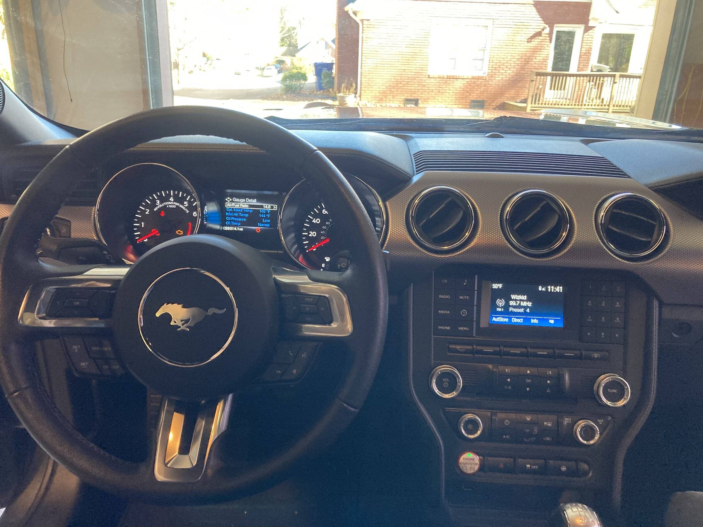

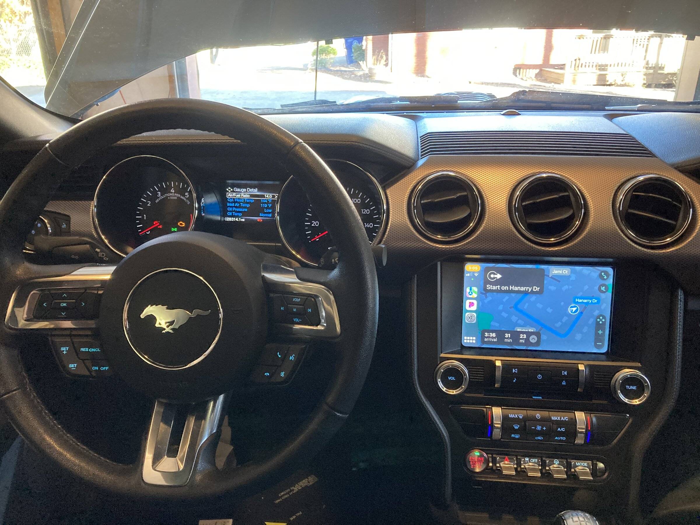

I ordered the kit from Infotainment.com less than 2 weeks ago and it came today. Install wasn’t bad and it works exactly as it would from Ford.
