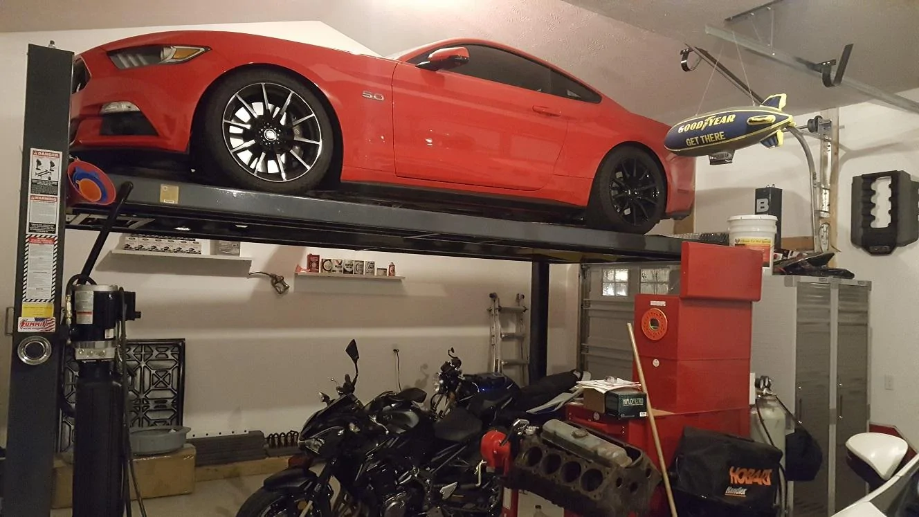

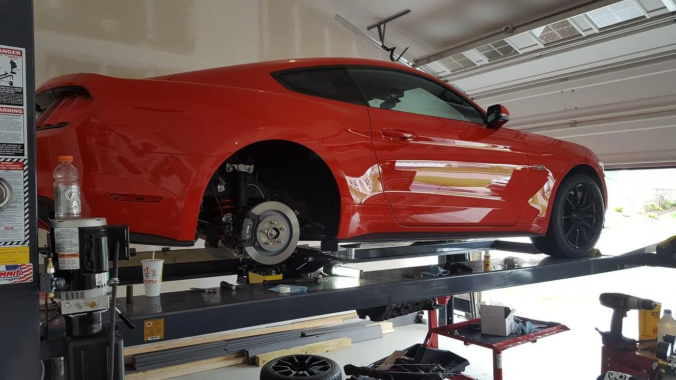

I have a BendPak HD9XW (9k lb 4 post) with a trolley jack and love it. I have the safety of a 4 post, can park under it and it has oil catch trays to fit between the rails. With the trolley jack I can still work on suspension and brakes.
