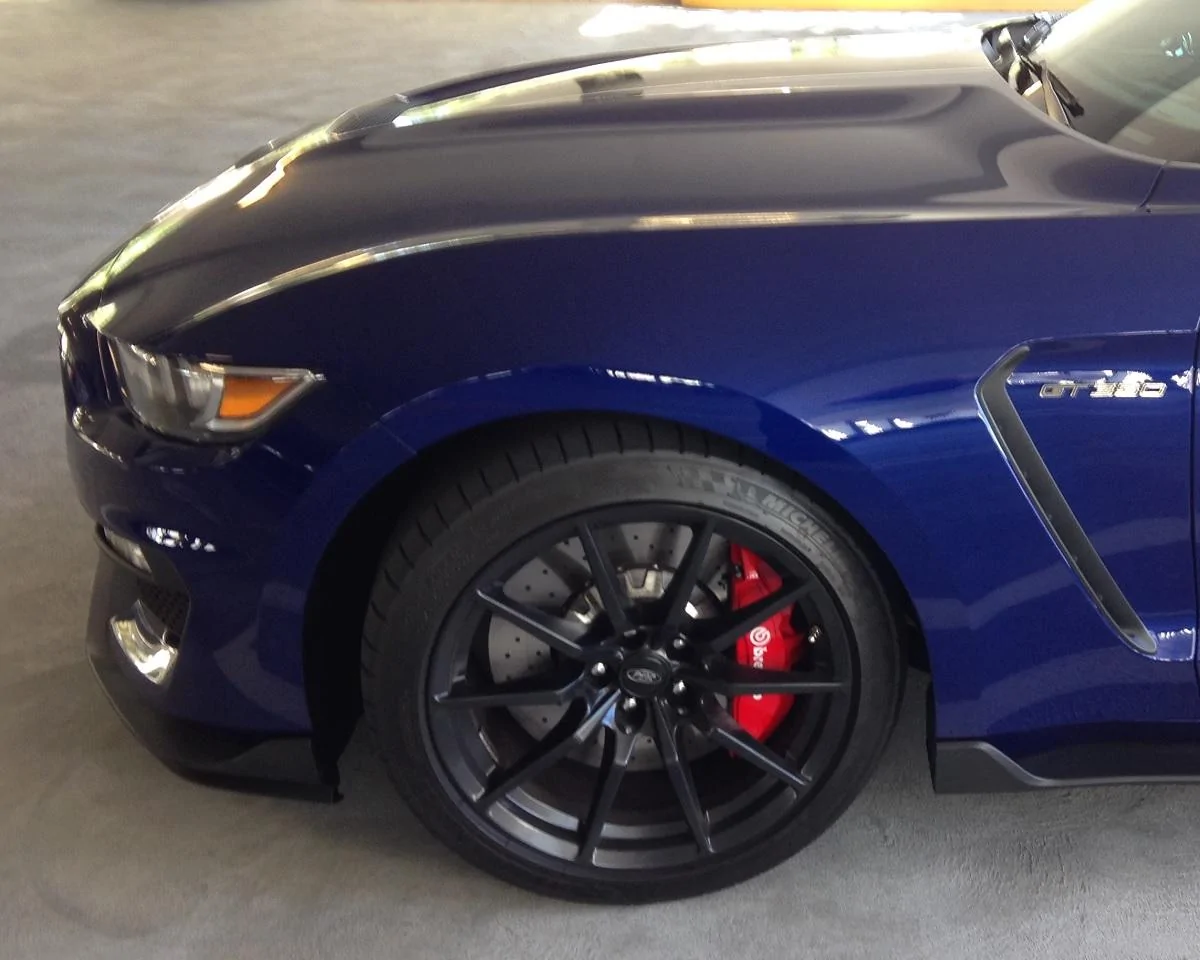

So I can get the parts way cheaper online and not pay sales tax so that is a win. I would like to have the parts professionally installed for my peace of mind. I doubt that a ford dealer would accept parts that I bring to them. What would you all do ? Would you take it to a local brake shop like Firestone or something ? I feel like may be a bad idea lol.
Maybe I just need to man up and do it. I am sure I can, just being a chicken.

I took mine to my trusted Mechanic at ZCar Garage and had him do it. :)
So in other words... ask local friends who have friends for a mechanic they trust. It's not really too hard a job and any good/trusted mechanic should be able to do it. I could have done mine, but I just didn't have time.
This is the note I sent out to my mech:
"I’m not sure if you can help or not, but I’m in the search for a trusted mechanic who can do a direct Brembo caliper swap on my new ’16 GT350. Looking to swap the Black calipers for the Red calipers. I have all the parts in hand. Would your shop be able to do that or do you have any trusted leads to throw my way?"
