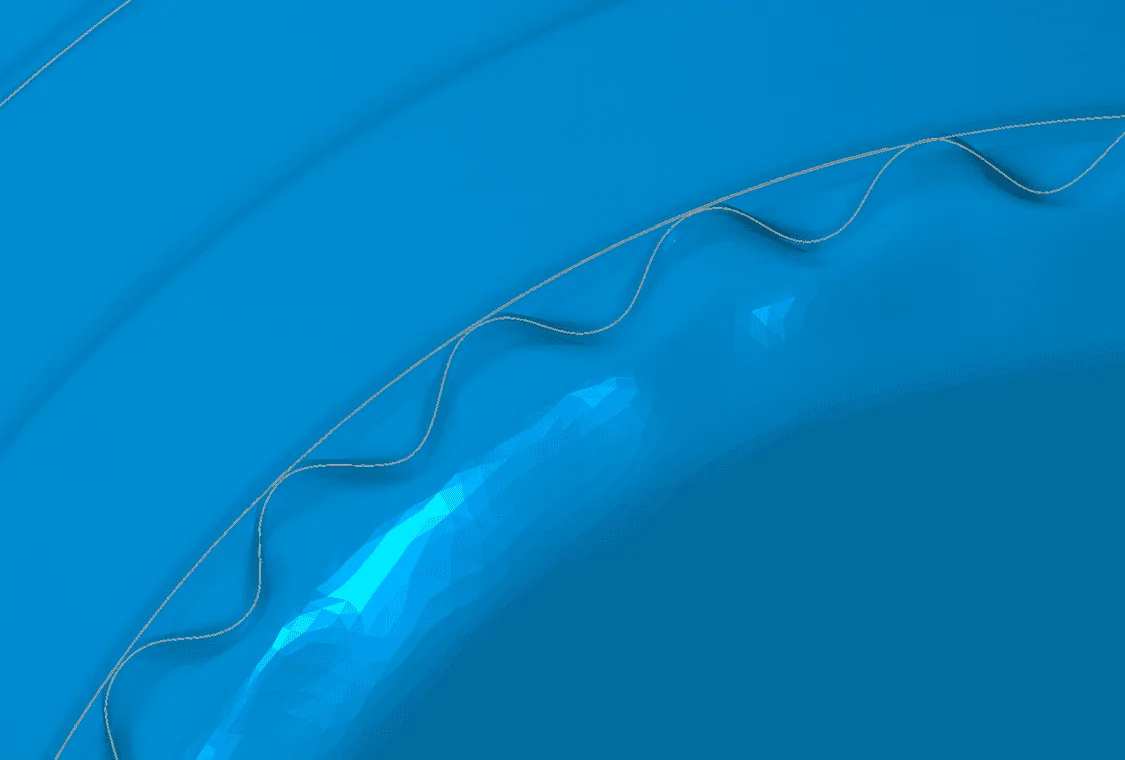

I've been tasked with designing a shaft that fits the 2015+ mustang S550 differential.
I understand that this is a 34 spline axle, but that only limits the selection so far.
A scan of one that I'm using doesn't seem to be right to me, looks like a serration spline which is good for centering, but not for carrying torque.
Does anyone know the actual specification for which type of spline it is?
Thanks so much to anyone who can answer this for me.

Can't really say what it's for, but can say this is a custom racing application where a ford rear end from a s550+ 2015 mustang is being transplanted into something else.
I'm just here to do the engineering.
The stub shaft I have to reverse engineer has no markings so my theory is that it's aftermarket to begin with. And maybe the splines aren't the right ones.
I would think an involute spline would be a much better choice than a serration spline. And in fact is what appears to be used on the Outer Axle/CV.
Freely admit I'm no expert on splines, not my FIRST rodeo, but...
