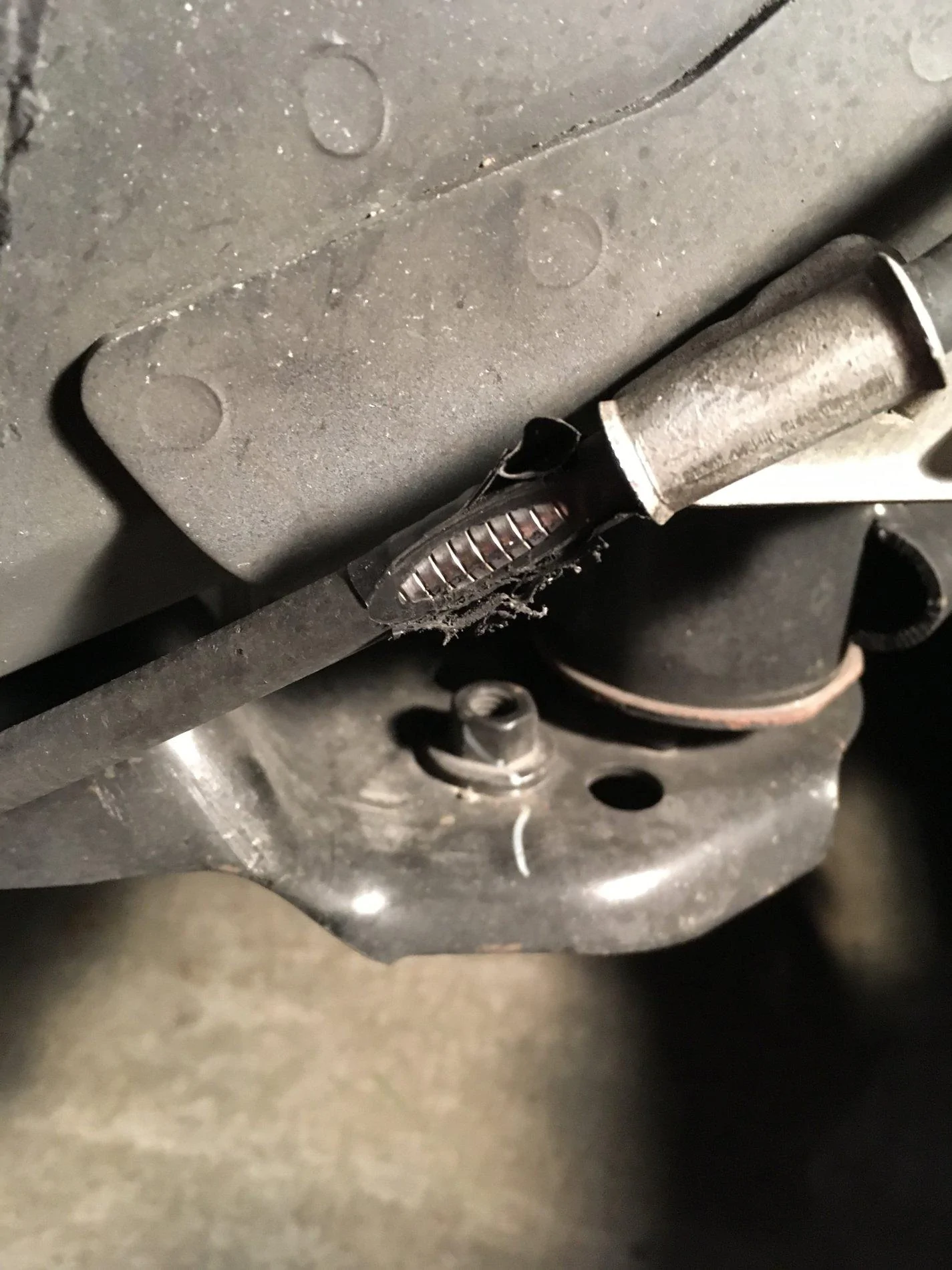

Yes, but if you run more negative camber than stock, you’ll need to remove the metal parking brake cable bracket and attach the parking brake cable closer to the fender. Otherwise the tire will rub on the bracket and the parking brake line. See pic.
Do you have pictures of the 315's on your car?

I think it depends on how much negative camber you're running. I've run two sets of MPSC2's 315's on stock GT350 11" rear rims and never had a problem at 1.1 degrees.
Bingo. At 2.0 degrees negative camber, I get the results shown in the pic above.

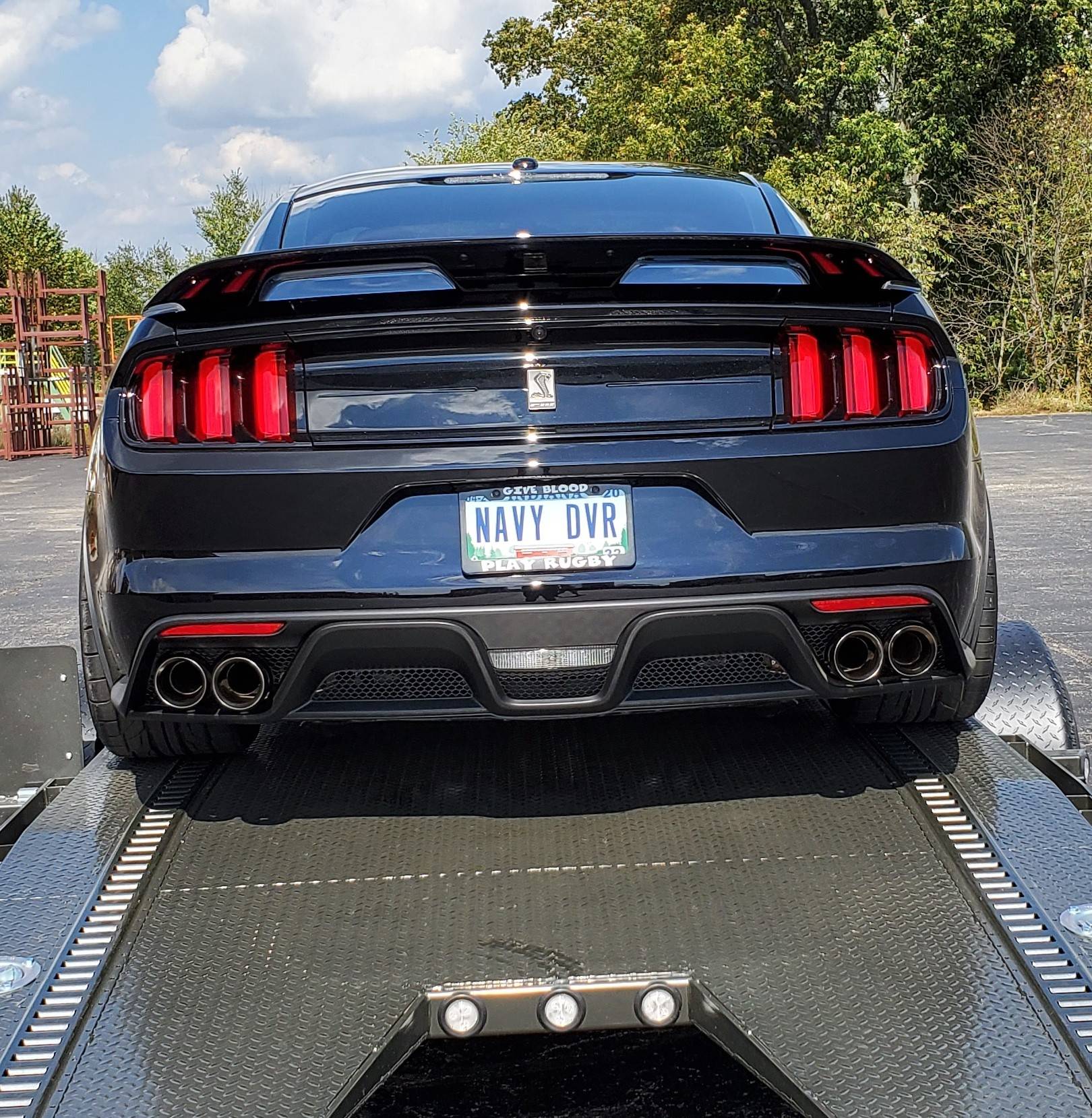

I, too, am running 315/35R20 on the back of my non-R. They are on 20x11 MRR M600 wheels. Stock camber...no lowering springs.
