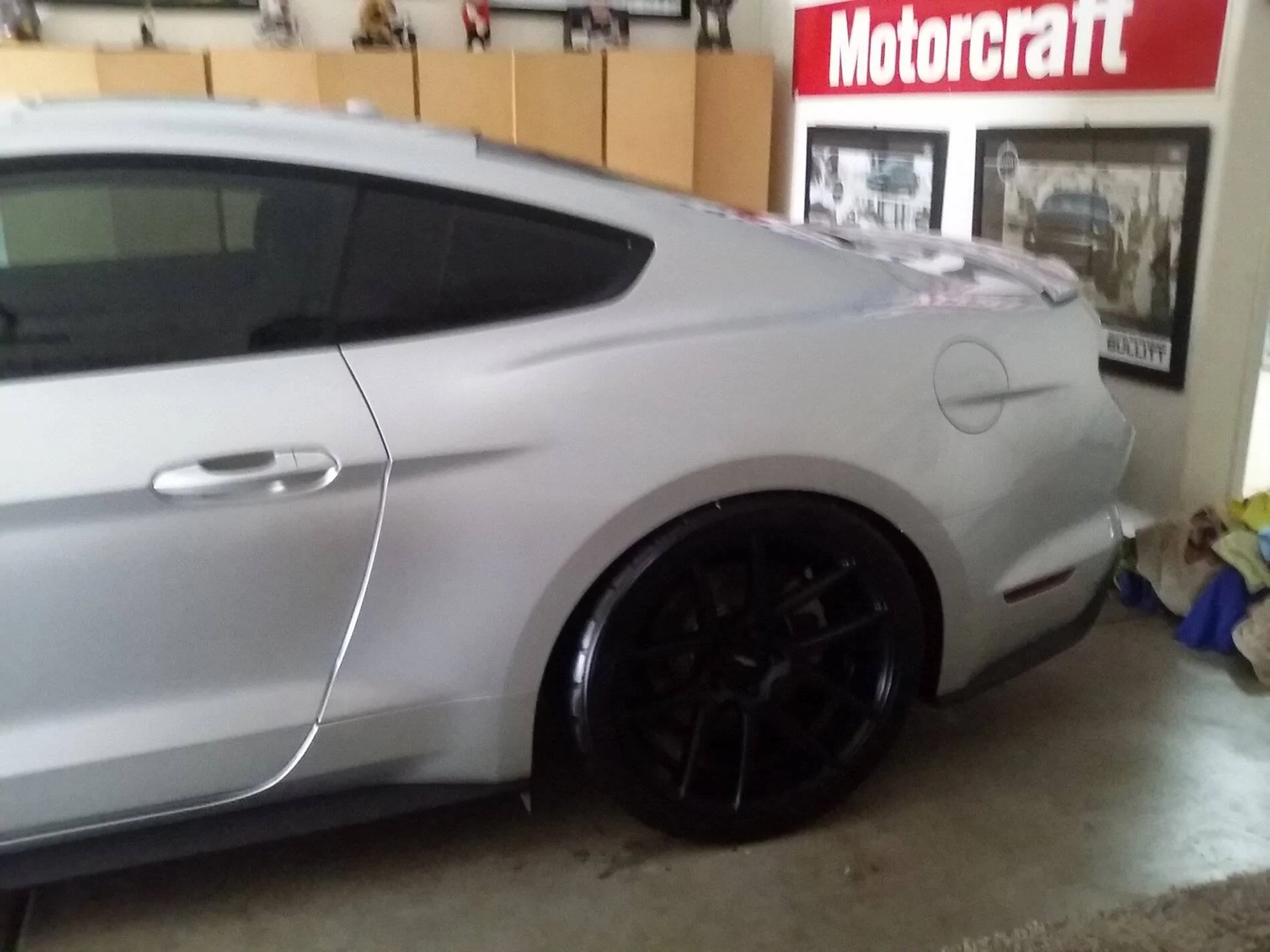

I run 305's on a 10" shelby c70 wheel. Fitment is great. This setup was recomended to me by american muscle.

305/30 on a 10.5 wheel .1.5 drop no rub .

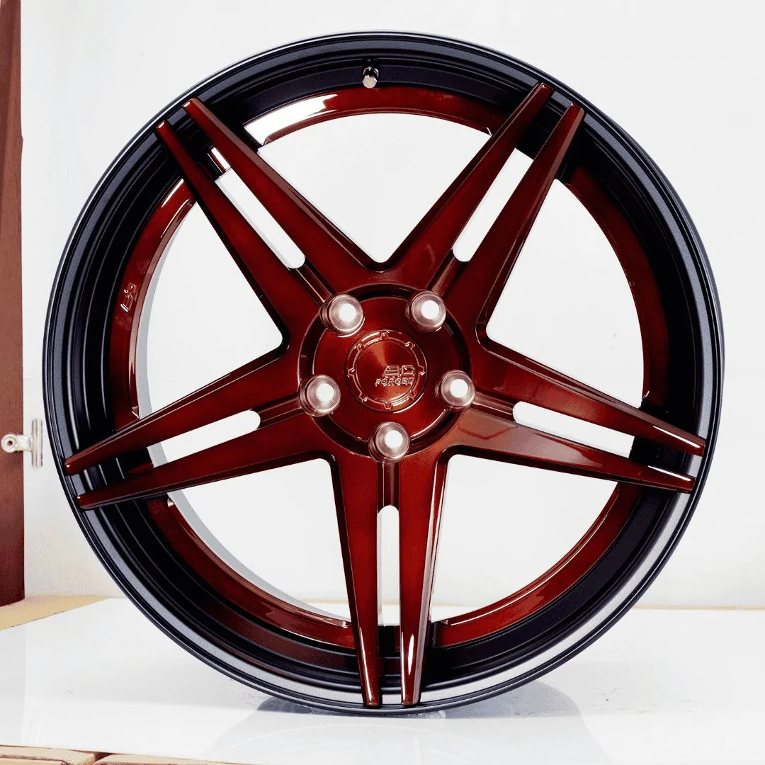

Hi. I am having a set of forged 11.5" rear to run 325/30/20, but with the 11.5 I can run other widths like the 315 tires. All depends on you want. Good luck

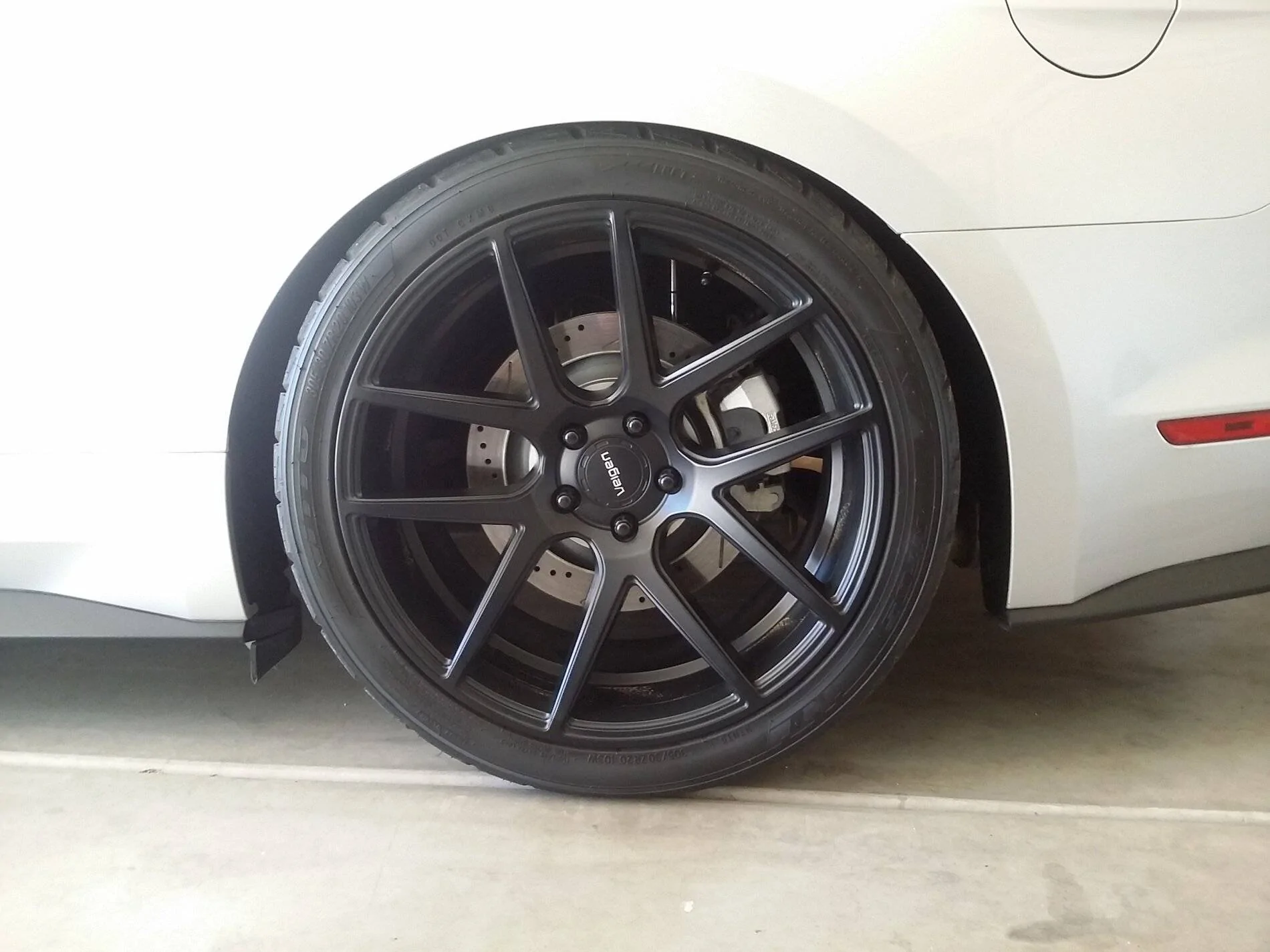

What's the offset on those? Mine were +35 10.5 and I rub a bit on freeway bumps.
wheel is a velgen vmb5 20x10.5 back space 7.52 +45 off set with 305/30 nitto nto5

Akio at PK Auto Design does these all of the time. He said me running the HC052 Concave 11.5" x 20" rear with 325/30/20 would be flush with fender and have no issue at all. They can even full custom paint anyway you want on the wheels from the manufactures. They set me up with mounted tires, with TPMS sensors, Ceramic coating applied, everything for Half the cost of other High quality 100% T6061 Aluminum Wheels. Manufactures. Post more pics of yours. The more everyone post their successful mods, the better choices others can make. Thanks
