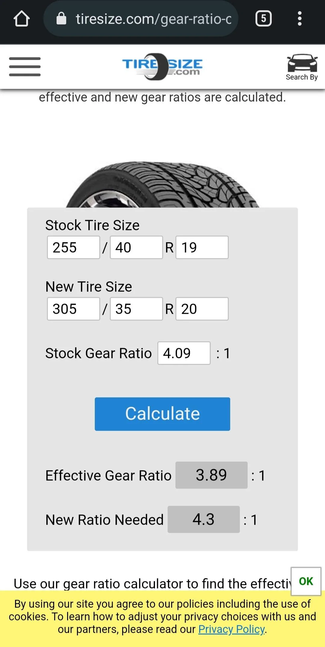

I dont run a 3.90, but I went with aftermarket wheels and tires a few months back; the change in tire diameter essentially made my gears taller; so i decided to swap out my 3.55 to a 4.09.
The 4.09 in my car is essentially the same as a 3.89 in a 2018 mt on Pirelli 255s.
I absolutely love it.
it took me a few days to get used to it as my brain was so used to certain shift points and feelings, but I quickly felt comfortable. And the car definitely feels quicker.
I don't do a ton of highway driving, but theres no problem on the highway at 75/80 in 6th gear.
