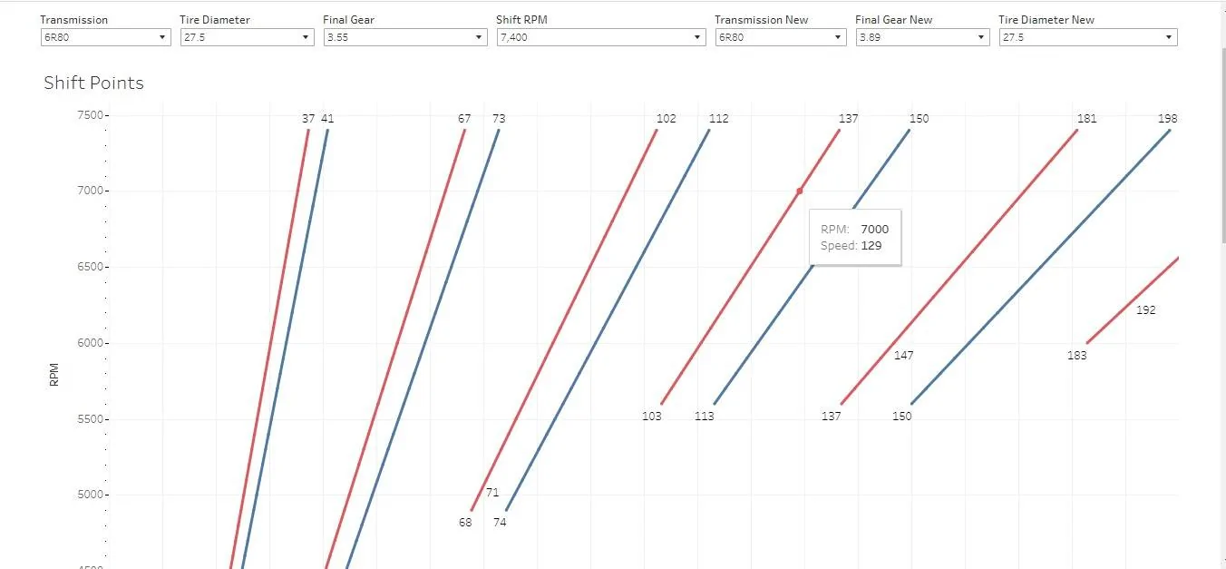

Does anybody run 3.91 gears in their automatic 6speed? If so how do you like it? I do bracket racing on the weekend and was thinking of going from 3.55 gears to 3.91 gears. I have most basic bolt-ons.
Thanks

Here's your shift point & speed 3.55 vs 3.91 (3.89 in this case.. close enough)
