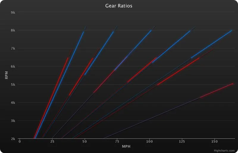

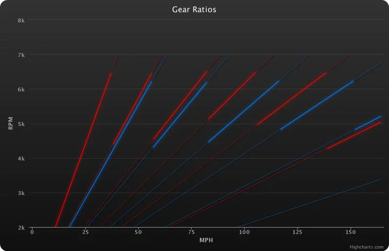

GT 3.73 & GT350 have very similar gearing (GT-red & GT350-blue)
GT 3.73 & GT500 ('14 w/ std FD) 3.31 are of course different (GT-red & GT500-blue)
The chart gives idea of spread between gears, rpm drop during upshift and mph.
