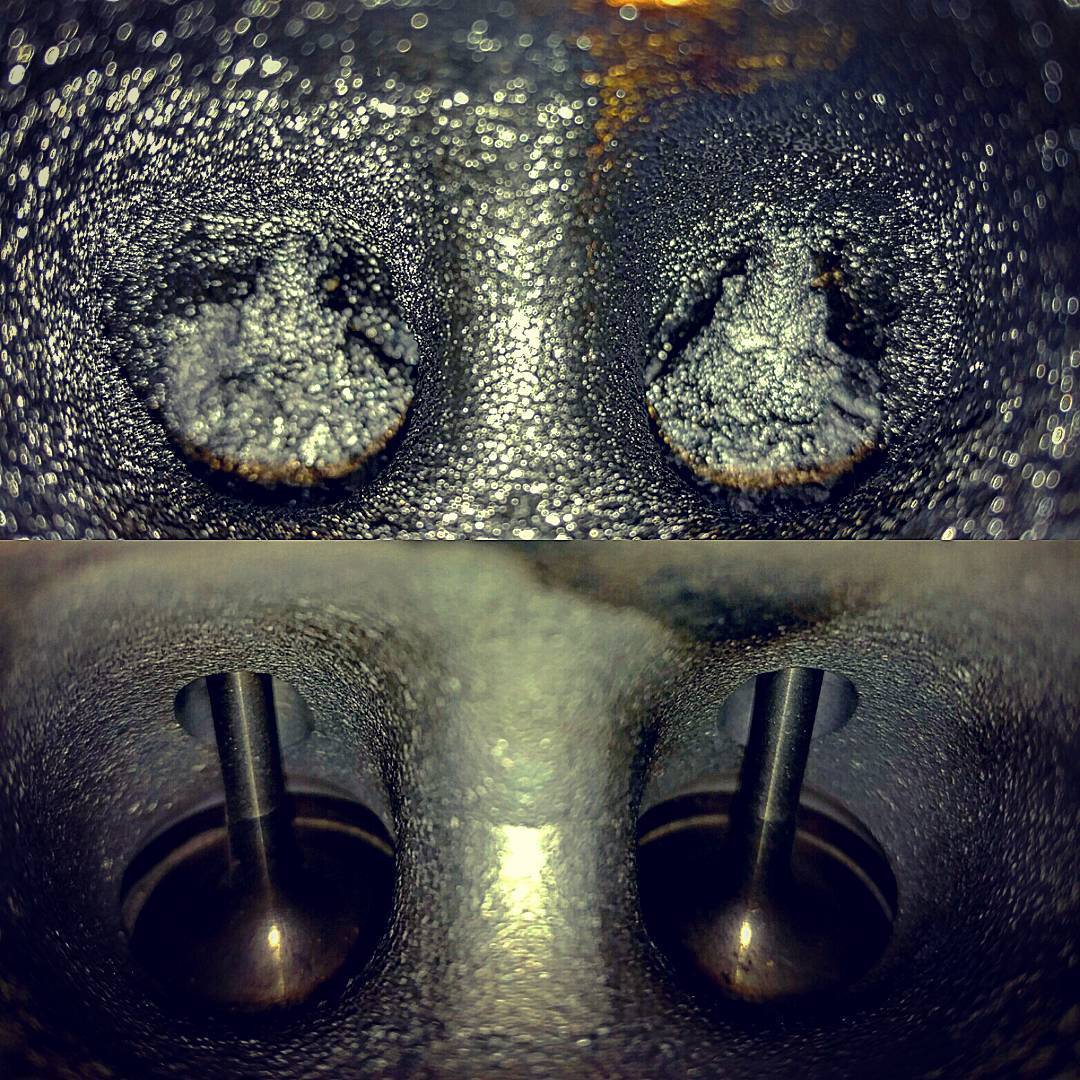

Y'all are missing the point on this DI engine and a catch can. It's not for oil consumption and I'm happy that your engine didn't use oil, mine doesn't either. The point of the catch can and I can't believe I have to explain this is to stop the oil and combustion byproducts from cooking to the backside of the engine valves. Newer designs of the engine added upstream injectors like my 2019 Bullitt for example. The fuel spray upstream tends to clean the valves of this crap. The older style DI gets blowby coked to the valves and performance takes a hit. This is well documented on the internet. Driving slowly and extended idling probably makes this worse. It would be a gradual thing and over time you wouldn't notice it. Not like all at once it would have slower acceleration. It can be cleaned out with blasting media or nut shells from the intake side but who wants to go through that.

I only run premium fuel in my explorer and God forbid mine would ever get THIS bad. I wind mine out to 5,500-6,000 once and awhile. Ours gets DRIVEN... LOL. It's about due for a PTU drain and refill. I'm more concerned about that little bugger than my valves. We do run a can of that injection cleaner once and awhile. The one with the annoying commercials.

those pictures are real nice, what engine, what milage, what else was wrong with it, what type of use? police car idling for hours on end, taxi , track car, drag car? what type of driving habits and what brand and type of fuel used, ? Engine oil changed how often and what brand and specs. pictures without full disclosure of all pertinent facts prove nothing. too any possibilities with too many questions left unanswered and without real proof as to cause and vehicle/engine involved.
I am not questioning your take of these pictures just that they prove nothing by themselves, Once again ...Life is good. enjoy it!
