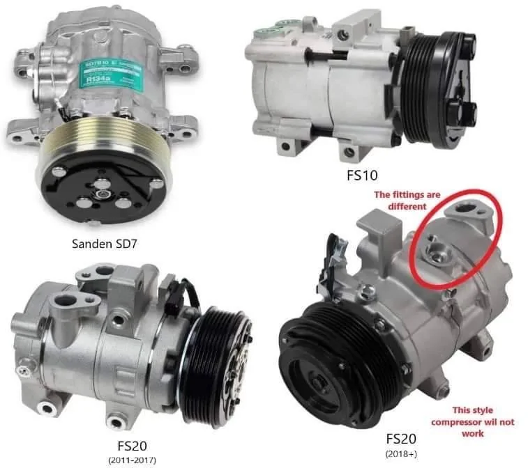

Sooo, is the 18+ compressor different? RockAuto shows the same part for any year. But I found a used one from a 18+, and the seller thinks they are different and not interchangeable.

I'd like to know too. I have one for sale, it was bought for a 15 to 17, the part number crosses to 11 to 14, auto zone says it fits up to 18 tasca says only 11 to 14. The place I bought it from says 11 to 22. I was going to install the one I bought but found out ESP covered it. So I have one for sale.

While I was price shopping, I decided to look at the regular mustang parts. According to RockAuto listings, the mustang had a different part from the 350; not the same compressor and not interchangeable I assume. It was much cheaper too.
I was under the impression that they were made from the same company. Could be mistaken, but it would make sense as the GT350 did not get a big facelift in 2018 like the regular stands got.
The part numbers are different. The old compressor part number is YCC-551 and the new compressor is part number YCC-465. The 465 is only applicable to the 2018-2023 GTs. The 551 was for the 15-17 GTs and the 15-20 GT350 and GT350R.
