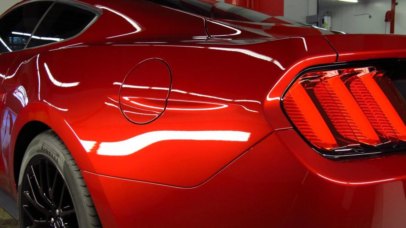

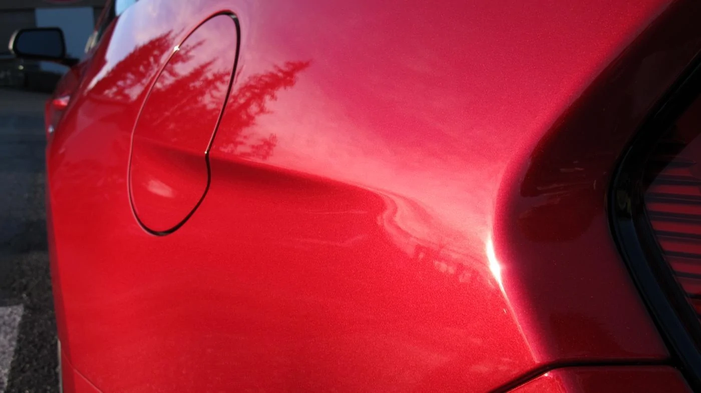

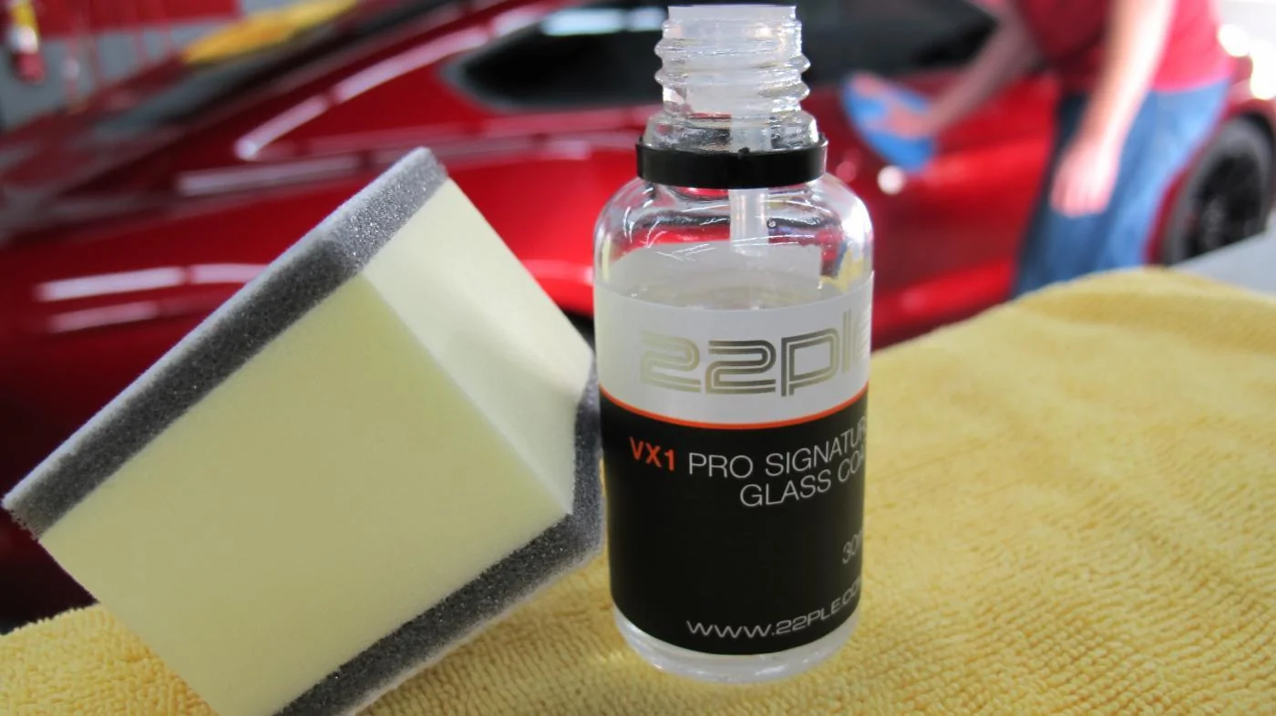

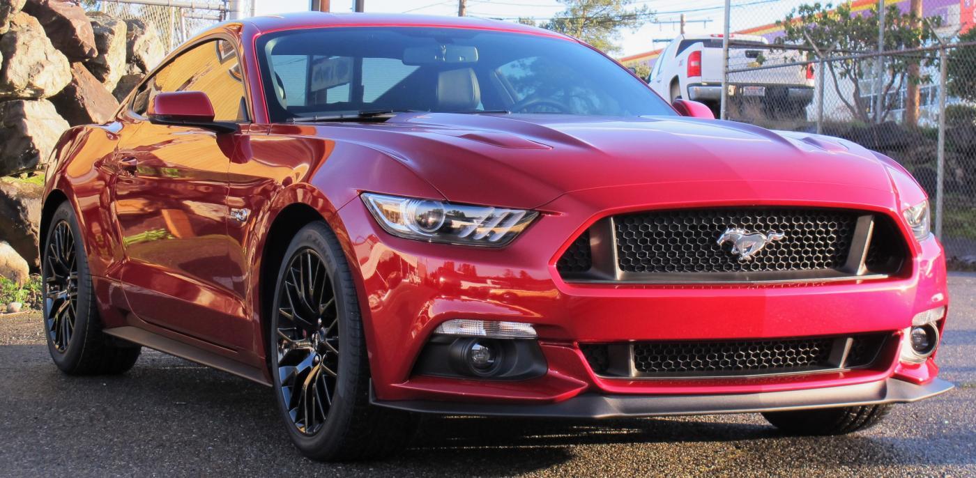

Since I haven't had the chance to do this to my personal car I figure I would post pics of a customers car and also a mustang6g member.
The exterior of this 2015 was in good shape from the start, and I'm sure most people would be content with the way this particular mustang looked, but I knew we could really make the Ruby Red paint pop. After spending roughly 10 hours polishing the exterior to correct any and all paint imperfections, we were ready for 22Ple.

i have the 22ple pro on order, will be doing my car as soon as i get it in 12 days. That stuff is simply amazing. None of the current coatings can match its "wet" look. That car looks as if it were just dipped in clearcoat! It is pricey though.
