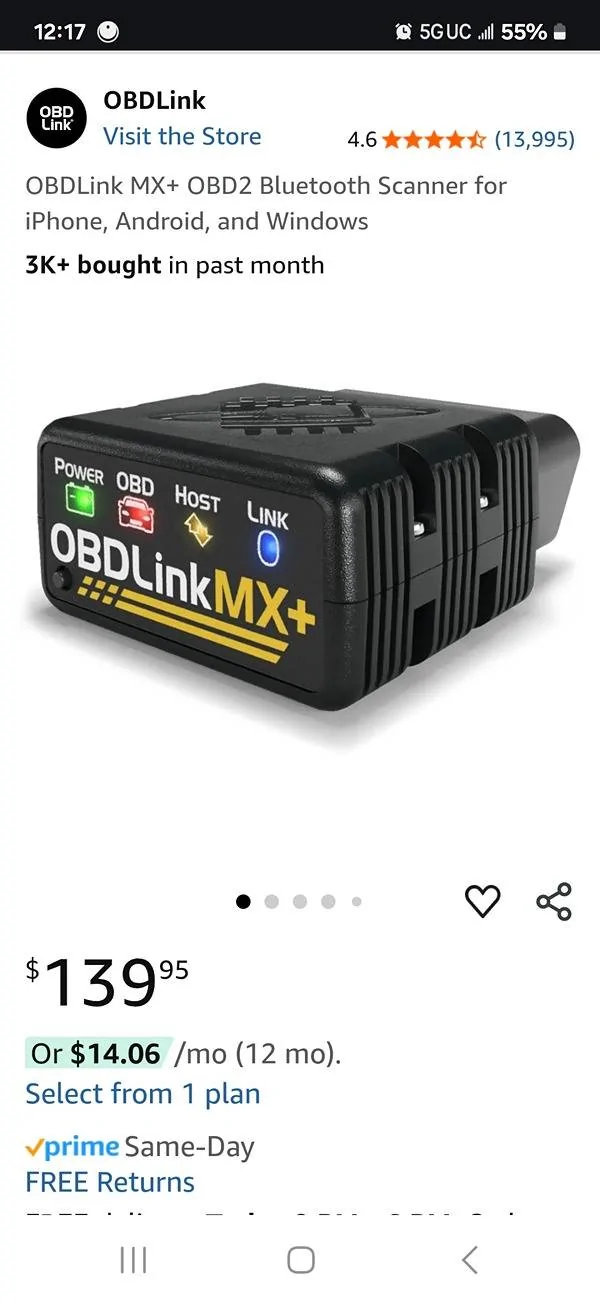

Get a scanning tool to log your drives. I had a bronco that would stall on a hard right turn takeoff from a stop.
I look into it. Where do I get one?
