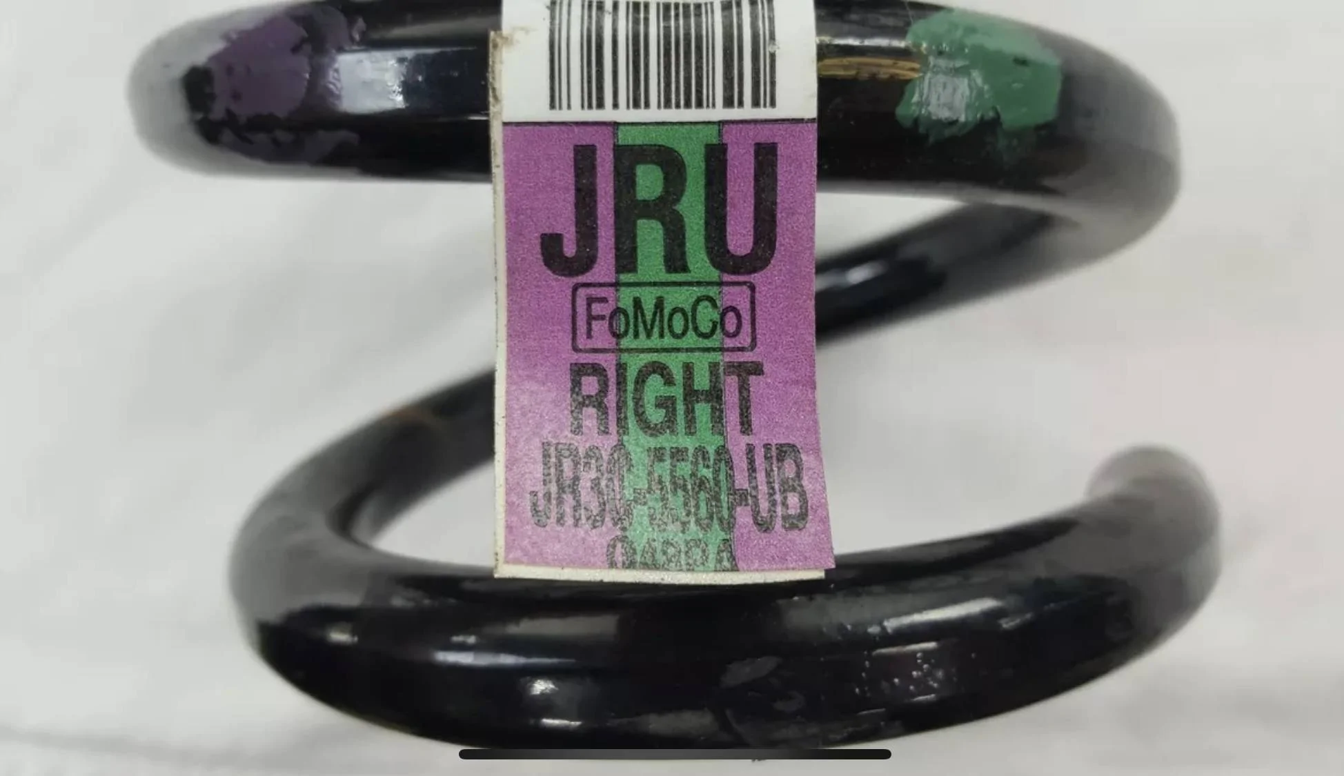

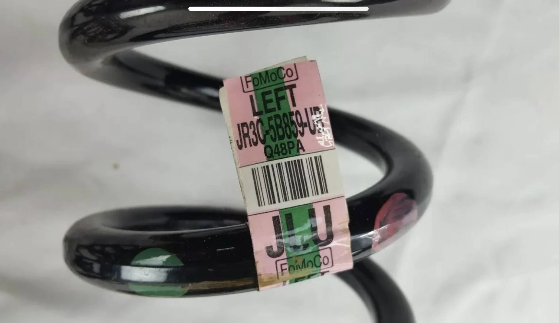

Maybe a dumb question, but do the different part numbers for the rear springs indicate anywhere which goes on the right or left?
They do but if you look at the stock spring when you remove it you’ll see exactly which one you need to replace it with. The springs are counter-wound so they’ll only fit the side they are designated for.
If they mark them up anything like the euro GT Magneride springs or these I found on eBay, it should be straightforward :like:
