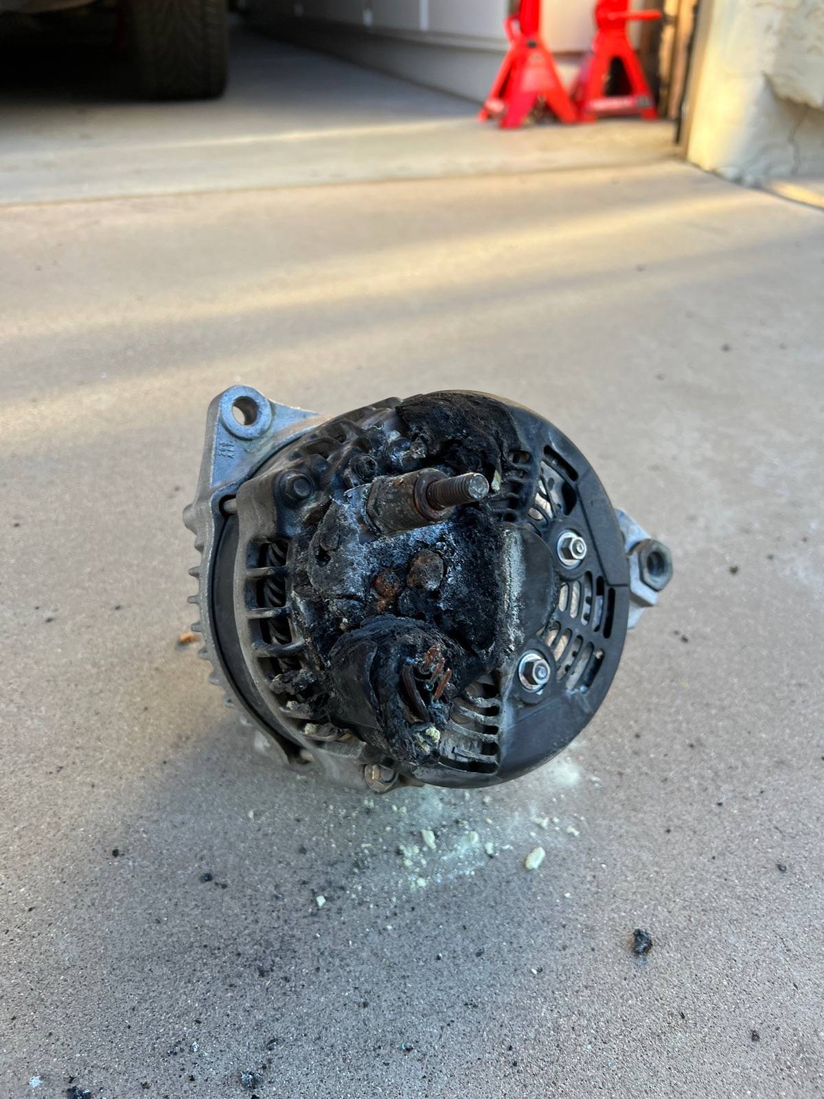

Long story short after a small alternator fire I’ve tried almost everything yet my 2020 GT Premium PP1 is still showing the infamous “charging system service now” error on my dash. Car reads 15v pretty consistently and throws codes P0626 and P065B. I’ve checked all fuses and replaced the mega fuse for the alternator and power steering, spliced in a new connector for the alternator and replaced the ring terminal at the end of the power cable.

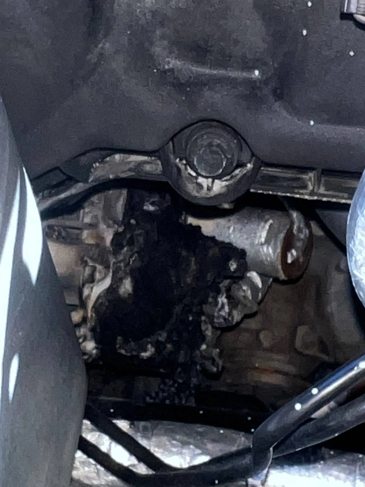

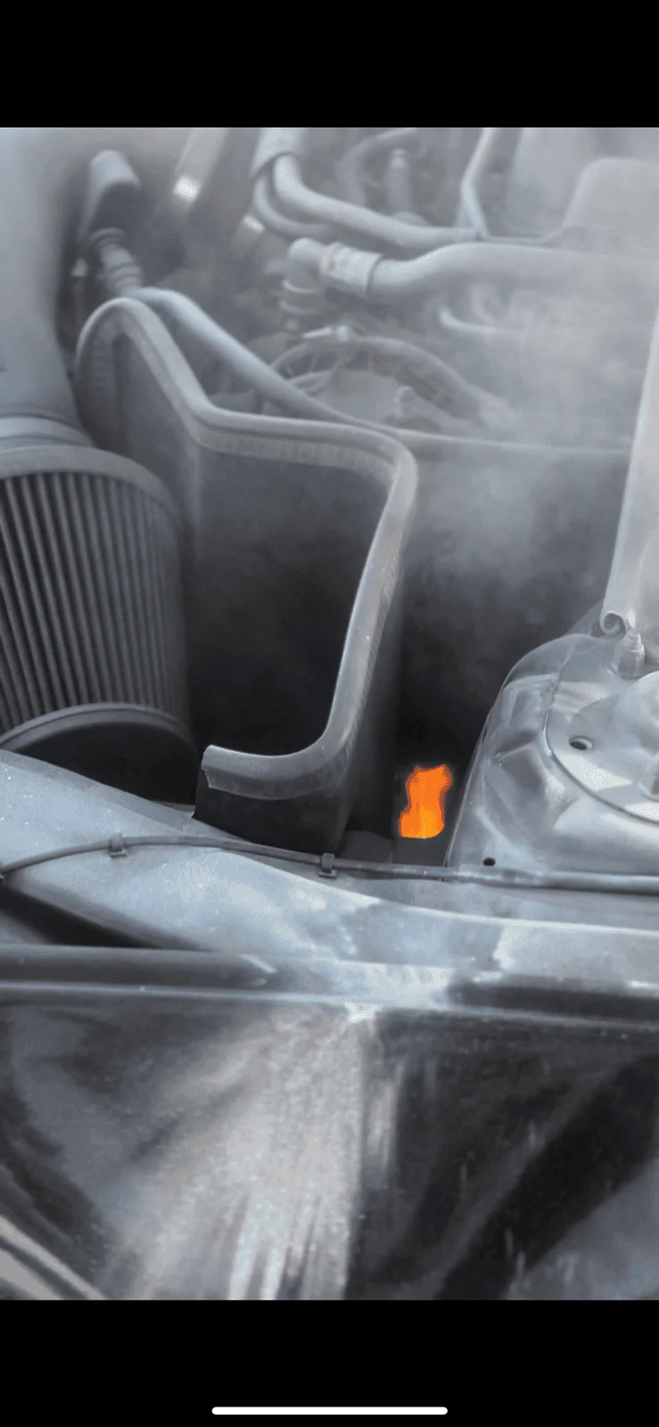

Long story long, about a year ago a buddy of mine installed bbk 1 7/8 primary long tubes on the car at a shop and rather than purchasing o2 extensions we decided to splice wire to extend the o2 sensors on our own. This was fixed after this whole incident happened along with purchasing new sensors. almost a month after the headers and ghetto o2 extensions were done, my cars voltage would occasionally drop, car would idle weird and die out at stop lights and my heated seats weren’t working. This led me to replacing the alternator because the voltage regulator tested bad at my local oriellys. I replaced the alternator with a reman from rockauto which was probably a bad choice but i had to do what i could afford at the time. My problems persisted and while inspecting the o2 sensors i twisted my driver side sensor and it fixed all my problems so I decided not to touch it from there and continued to drive the car as is. Fast forward to two weeks ago - I do a pull on my way home from the store and shortly after the message “charing system service now” appears and all systems went black and i lost power steering but my motor was still running, I coasted to my house and when i popped the hood my alternator was on fire, after an unsuccessful attempt to spray it with a fire extinguisher, i called the fire dept for them to take care of it. Since then I’ve replaced both upstream o2 sensors, added extensions, repaired the alternator connector and repaired the ring terminal that goes to the alternator itself and of course got a new alternator.

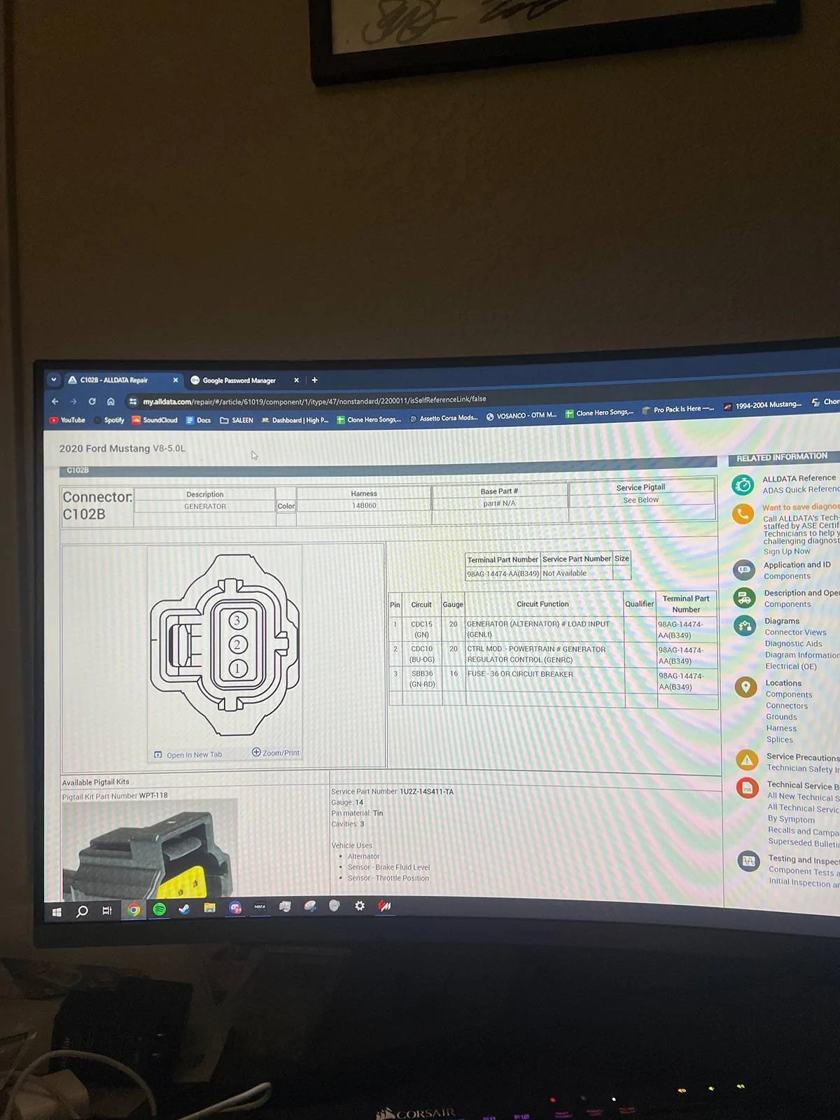

got it, that’s pin 1 and 2 on the connector according to this picture right?? i’ll have to search how to do the voltage test because i’ve never tested a connector like that before.

Yes sir. You just need to test it where it connects to the pcm with a test light hooked to battery positive. Disconnect the relevant connector so you can test the entire length (i dont have the wiring diagrams to know which). Measure the voltage at the alternator connector, if you have less than 12v you know you have a problem. If the test light Illuminates immediately, then you have a short to ground.

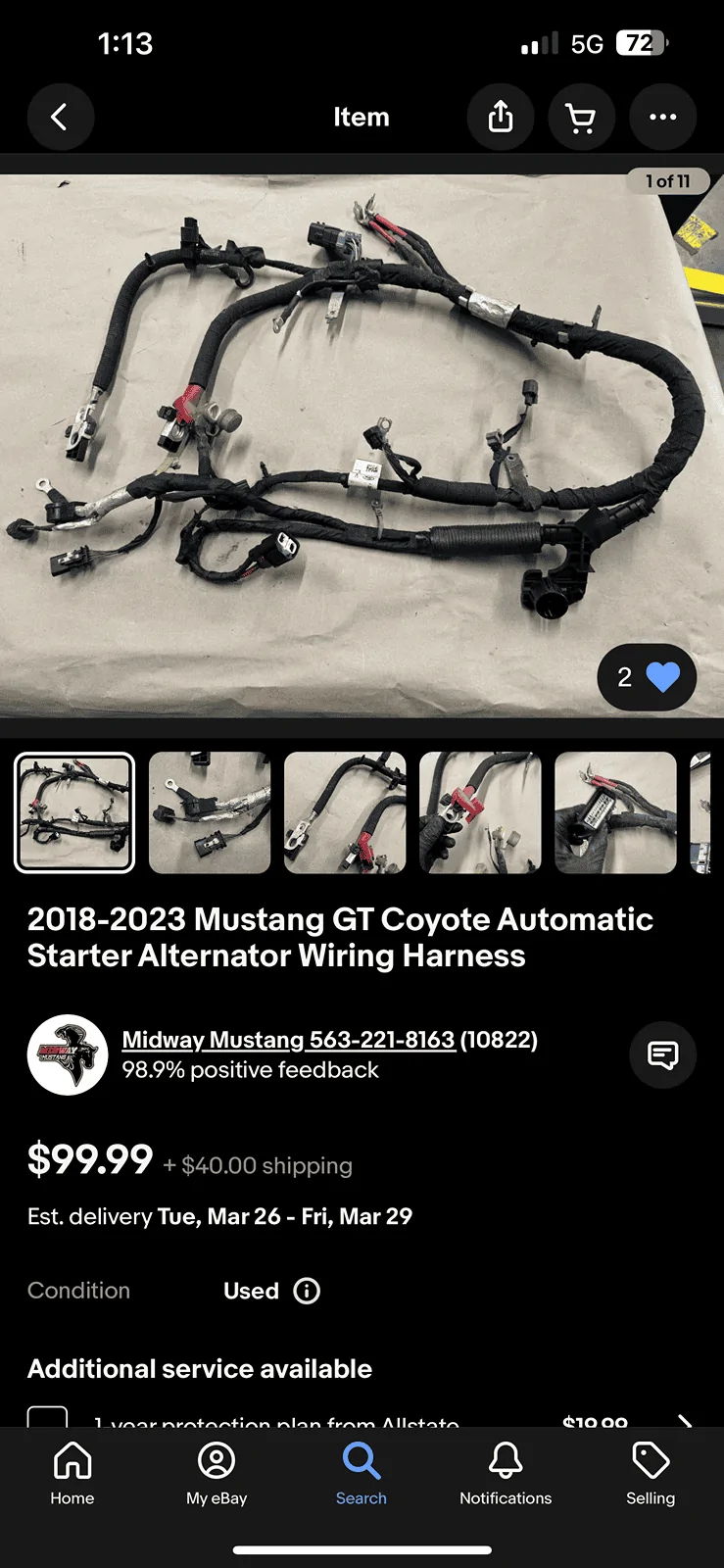

at that point would it be easier to just replace that harness rather than chasing a break in a small wire?
