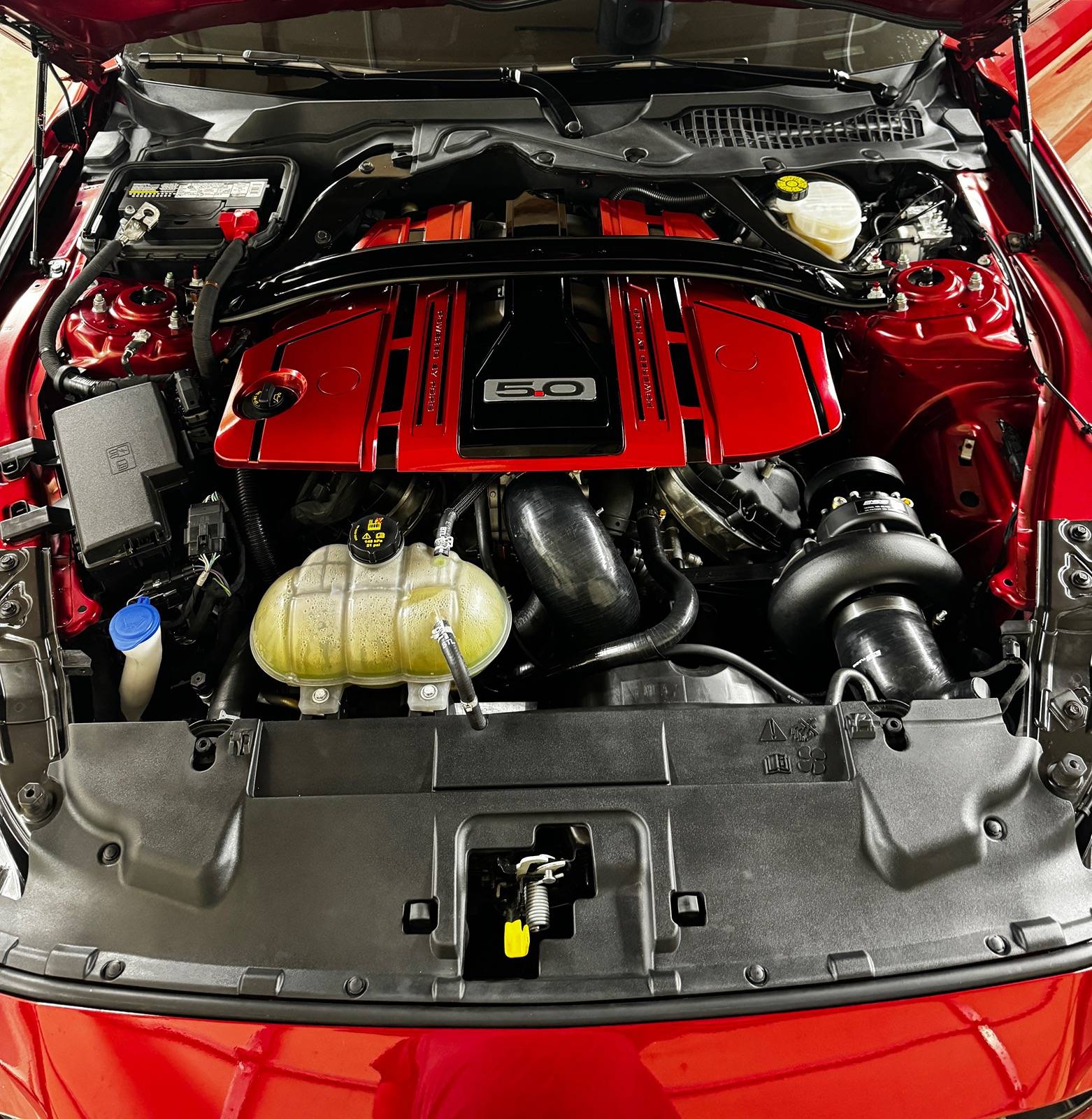

boosted my car with the ESS g3 kit 93 tune with catted headers. drove for about 1200 miles and my upstream sensors are having problems. is there a sensor anybody has been having good luck with? thanks in advance!
