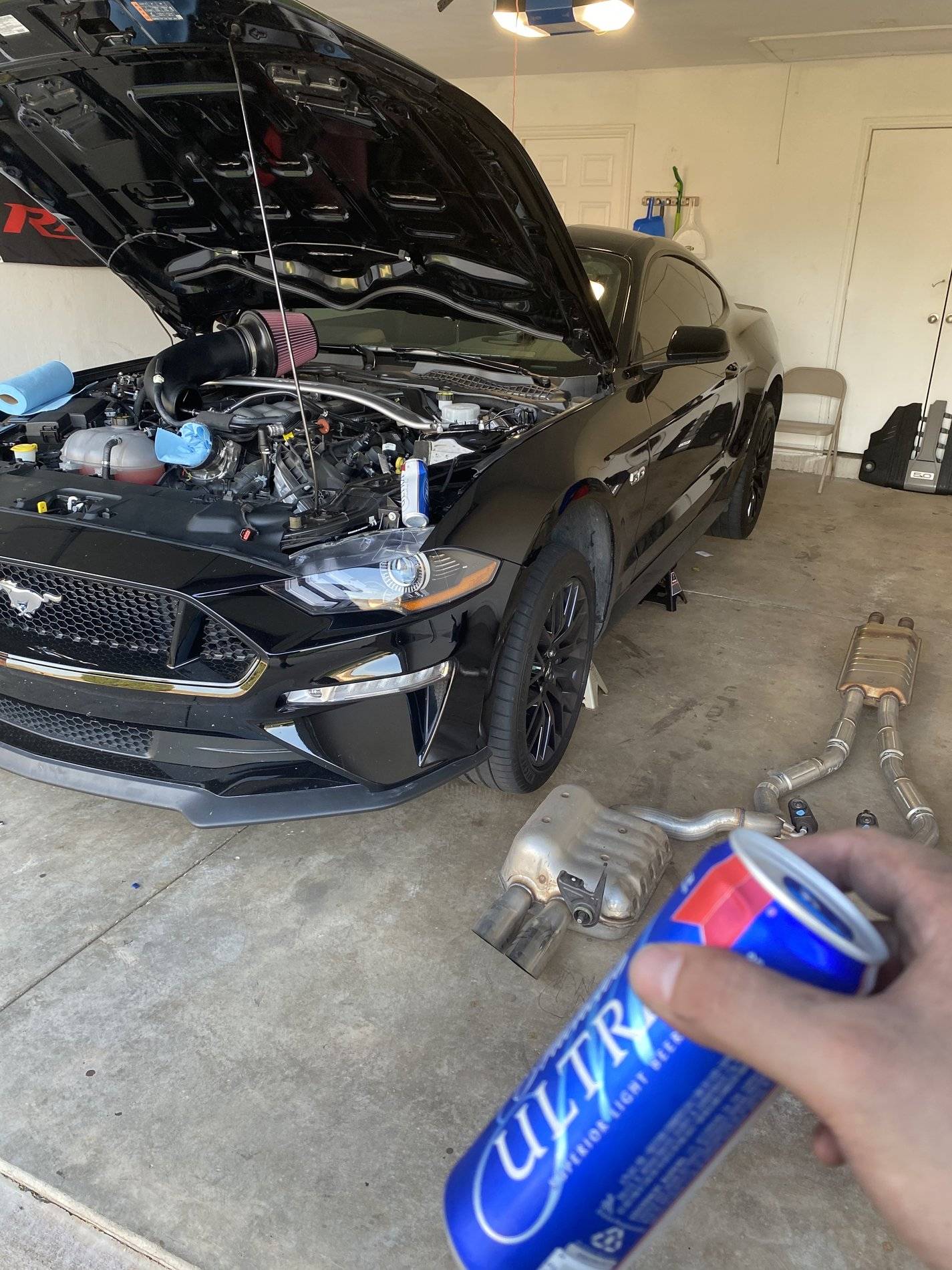

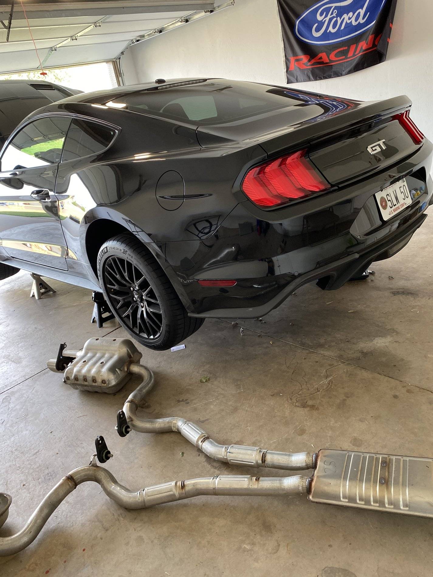

Bring a thread back from the dead. After 3 months or so, my exhaust comes in tomorrow. Starting to take the stock exhaust today. I’ll try to take as many pictures as I can. Wish me luck.

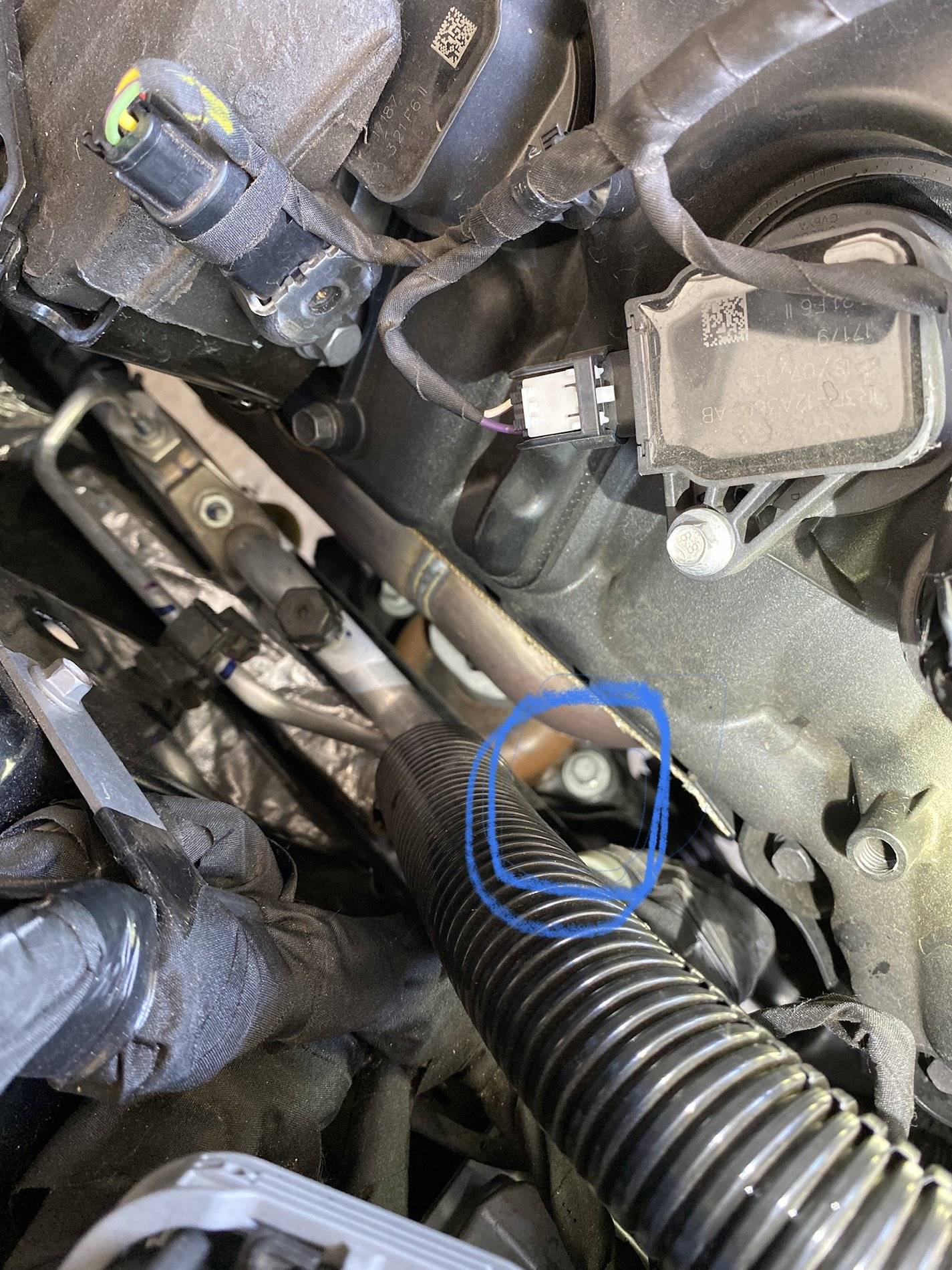

Anyone had a motor mount bolt get stuck half way out. Was using an impact. All 3 other bolts came out with no problems but this one got stuck. Won’t go forward nor backward

ummmm.... Someone correct me if I am wrong but I dont recall ever removing that..... Just the nut on the center of the mount.... Followed by the 3-4 bolts holding the bracket to the block... After raising the engine of course.
Shit.... I was following the CJ pony parts video and he took it off...

I removed the nut from the mounts on each side to get the brackets off. I loosened the two bolts hold the mount to the frame so I could wiggle the mount a bit when installing the bracket with the long tubes on the car. They are tough to turn. I would try to thread the bolt back in a bit using a breaker bar instead of the impact.
