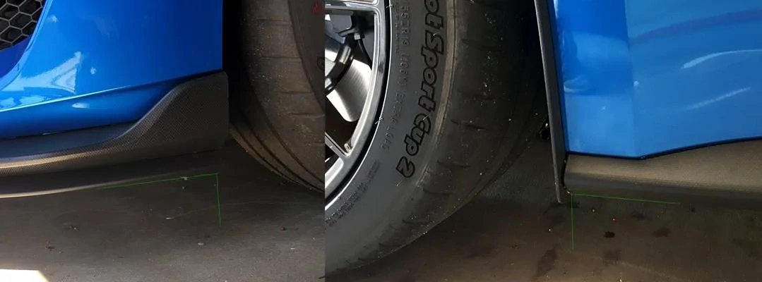

This methodology might not be the best, let me know if you want me to measure elsewhere.
With both of these measuring points I was able to see the same point on the left and right sides of the car at the same time, so I could line them up and look at the tape very easily. Front was measured at rearmost and lowest point of front splitter (measured just in front of wheel well). Rear was measured at the frontmost and lowest point of rear plastic trim piece.
Front pass 3-13/16"
Front driv 4-1/16"
Rear pass 6-3/8"
Rear driv 6-1/2"
Avg front 3-15/16"
Avg rear 6-7/16"

Wow! Thanks for this. I have over 5 up front. Something's definitely off, and it's not my calibrated eyeball.

A better measurement would be from the from rail to the ground. The fuel level, wheel size, tire size, and air pressure in tires will change all of your ride heights. The spring rate on the 2018 GT350 non R is 194 lb/in front and 914 lb/in rear. Spring rates on 2018 R is 240 front and the same 914 rear. When I do the same measurements you did from the bottom of the side-splitter to the ground on my 2018 non R, I get 6 inches front and 7 inches rear, same on both left and right sides. I have the OEM 19" wheels with OEM Pilot Super Sport tires 295/35/19 and 305/35/19. Air pressures at 32 PSI, full tank of gas.
