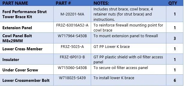

May be worth a shot. I added that along with the cowl support and strut tower brace and it felt much tighter.
Over time I have done a complete addition of PP1 bracing on the front of my '19. Maybe because I did it last but the most noticeable improvement I felt was from the cowl extension panel as well...

I added all of these items that are stock on the PP1. I am not sure about your need for the lower brace having the Steeda but that does mount aft of Steeda, plus it makes changing the oil easier with the access door for the filter.
