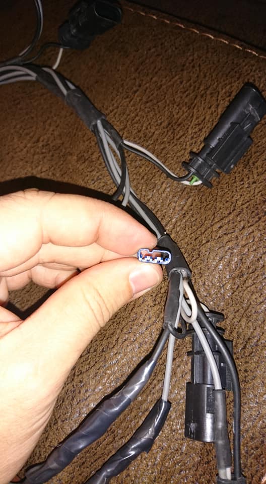

You need to remove the blue directional plug cap things (shown below) from the MSD female harness side for all cylinders except # 3. The reason you need to remove these is because the shape of the 2018+ factory ones is different and prevents the plug from connecting otherwise. Be careful plugging them in, you could bend a pin!

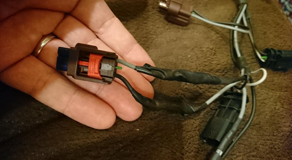

Now that you removed all of those blue caps from the female MSD plugs with the exception of # 3, you need to rewire the # 3 female MSD side pigtail as shown below. Simply switch over the wires. (The tape was temporary for testing, these will be soldered and heat shrink wrapped)

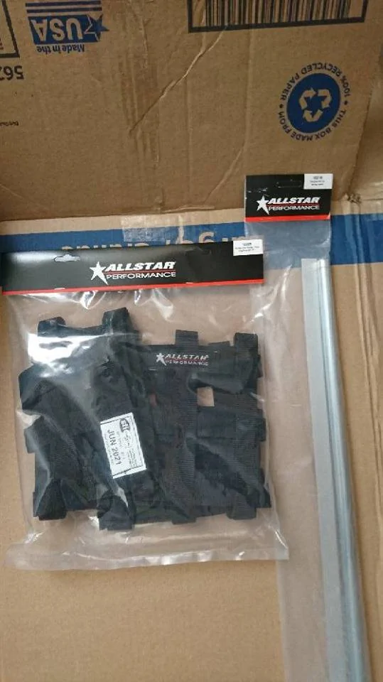

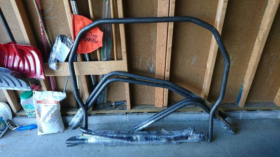

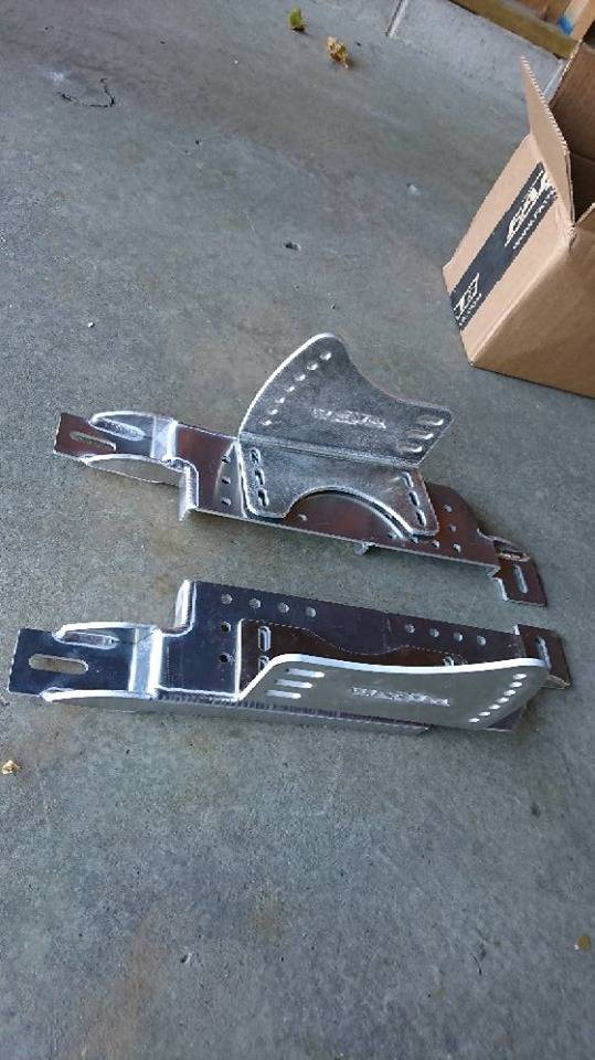

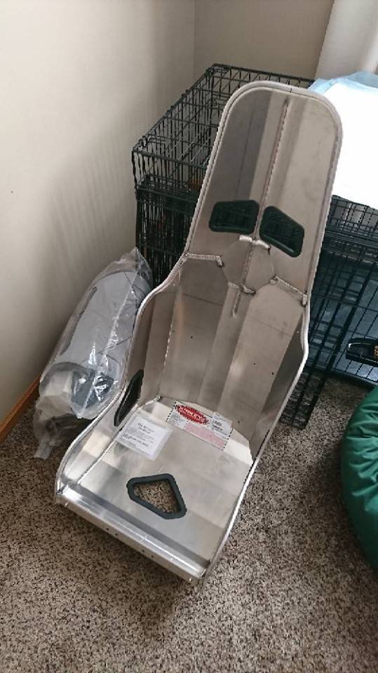

Big day!
The cage kit arrived, and I am pumped to get this going. Everything looks great. @ben@fatfab has been there with me non-stop with great support and communication. Highly recommended that you start with him. Here are some pics. My wife tested out the seat :)
