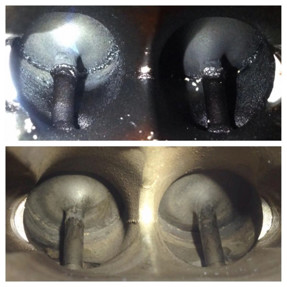

Ok so Im more a bike guy than anything these days so educate me, why is DI a problem?
Right now the fuel is sprayed on top of your engine above the intake valves. Direct injectection is lower and actually injects fuel directly into your cylinders, thus no longer pushing fuel over the valves. Gases have detergents in them to help clean valves (carbon build up). Those things are pretty much useless if the fuel is no longer hitting the valves.
My last car (15 WRX) was DI. They didn't use port injection with it like they used on the FA in the BRZ/FRS (direct injection + port injection). The problem with straight DI is the fuel is no longer washed over your valves which eventually causes carbon build up in them which eventually can cause some loss of HP or even causing the valves to stick or not seal properly.
Cars with a lot of oil blow by makes it even worse because it accelerates the buildup.

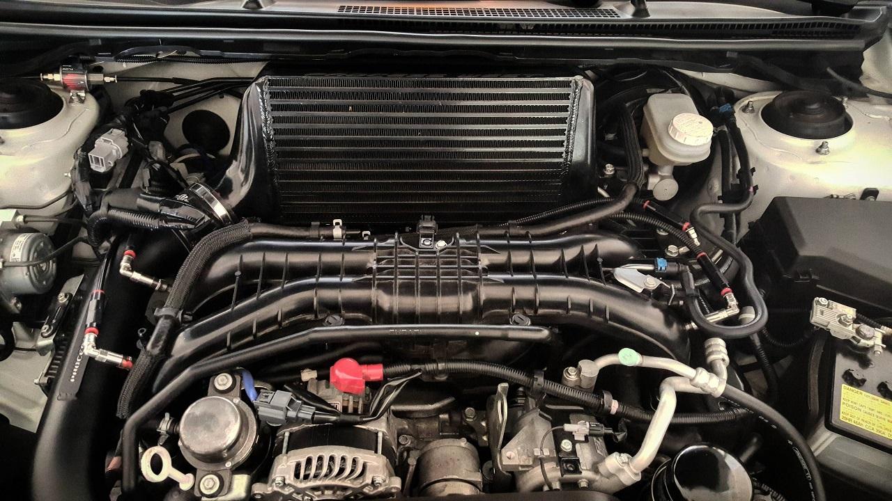

I had mine walnut blasted @45k miles, they weren't too bad. I removed the EGR before doing it to help assist in blowing the dirty exhaust gases back into the intake manifold. I also installed a direct port water/meth kit that spray above each valve intake which clearly was for power but it also aided and keeping the valves clean. It's basically like a steam cleaner with the water vapors.

On the DI note, I thought we had found out Ford wasn't having issues? Didn't they break open an F 150 motor with six figure miles and reveal it had only lost 1/2 hp?
Even if its no problem, I redline my ecoboost everyday for preventative reasons...

Interesting, seems the manufacturers would have a solution for the DI Valve issue. Again its interesting.

I had a BMW 135i, a car that you must walnut blast every 40-50k miles... it's amazing how gunked up it would get.
They do, it's called PFI-DI. The carbon build-up can be lessened through calibration, but not eliminated on purely DI engines.
